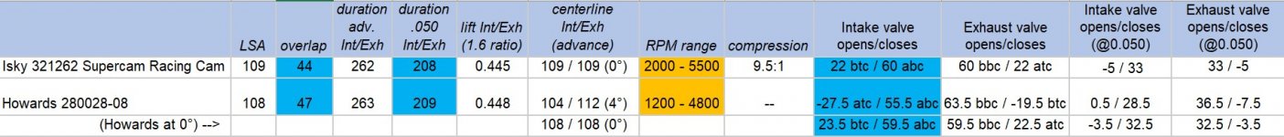

I know I shouldn't take the from the manufacturers suggested rpm ranges as a given, but I have to ask to fully understand this:
Compared the Howards to the Isky cam, the have almost identical specs, why are the rpm ranges (orange) so offset?
I would understand differences at around 200-400rpm, but 800rpm? That seems like a lot to me.
I am asking because I also have the Howards cam in mind for my 200 with the C4 automatic transmission: with power starting at 1200rpm I think that cam would be fine for an automatic, but with power starting at 2000rpm I wouldn't even consider this camshaft... so what is the more likely true lower rpm limit for the Howards?

The Howards # on your graph does not match, but if it's the cam I'm thinking: the Howards has 108* Lobe Separation Angle. The Isky has 109*. The graph above shows the Howards advanced 4*, the Isky has 0* advance. So the Isky closes the intake valve@ 60* ABDC, the Howards closes it @ 55.5* ABDC. This is the RPM difference. BTW- 55* closing will 100% require premium fuel if using the EFI head, the dynamic CR is 7.4:1. But low-end torque is fantastic. . The reality is, both cams will start to pull strong by the low to mid teens.
...the Howards has 108* Lobe Separation Angle. The Isky has 109*. The graph above shows the Howards advanced 4*, the Isky has 0* advance. So the Isky closes the intake valve@ 60* ABDC, the Howards closes it @ 55.5* ABDC. This is the RPM difference.
In the last row I put the numbers for the Howards when installed at 0° for comparision...
I just don't understand how 4° cam advance make a difference of 800rpm. Everything I found online says 4° should move the powerband only about 200rpm, so we are off by a factor of 4. Is there any other important parameter I don't see?
This is the camshaft: https://www.howardscams.com/hydraul...ford-140-250-1200-4800-howards-cams-280028-08
These cams are for 144 to 250 cu in engines.
The 144 will have a very different power band than the 250 for the same cam.
There is no way to specify an RPM range for one of these cams unless a specific displacement and component combination is also specified.
We ignore catalog posted rpm ranges and rely on the data that has been accumulated by the many engine builds found in this forum.
