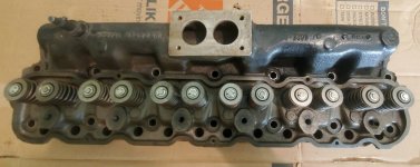

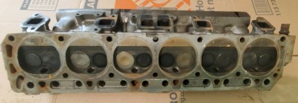

I'm working on pepping up my 61 Ranchero a bit for more reliable "daily driving".
Currently it has a 170 from a 1970 Maverick with the small log head.
I've found a large log 2V head, but it's a little different from others I've seen, pics attached. Looks like mounting a 2 barrel carb should be straight-forward. Anyone else have one of these, or know what type of carb would be a good choice for this mount ?

Great looking head what is the Casting number and Date Codes? (y) :nod:
2 X :...Casting number and Date Code..."
let's ID what it is as a starting place.
Measure everything U can (bolt CL to bolt CL, dia of the 2 'carb holes", look dwn deep into each 12 ports, cc head, measure dia of valve, etc, etc). Then U can (if not get more info like carbs as doing here) make some decisions.
Will this be a stop lght to stop lght cruser, strip car, grocery getter, 3Kmi per yr parade car, etc. The 'final application' (80% of use) determines the best choices from here~

Hi, nice score! With a head like that your engine will breath better.
I would have the valves and guides checked out. I would also CC the combustion chambers and figure out if it needs milling and if it has been milled before (probably has).

The head is an EO/ 80 largest log ''hex'' head ,it is a good head.
Be nice to have some numberson the bolt pattern of carb mount,but I'm gonna make a stab and say it looks like a rochester 2 bbl. like what I keep pulling off these old chebby.Pleas don't throw rocks at me...
Firepower354":1thihxwu said:
Did those have a divided exhaust port, stock?
No , that has been added..Note that that radiant fins have been covered over to better isolate the heat from intake.
One time I saw a mid 60s head the that I am sure was a stock port divided head on a comet.
