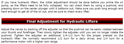

I did some more research, but I am sorry I have to ask again, since I am not sure yet what the correct method for setting up my adjustable rocker assembly is:
1) I understand the lifters should be pumped up before initial start up so that they don't collapse
2) So I can put the lifters pumped up into the engine, install the pushrods and adjustable rocker assembly
3) Adjusting the studs with the ball end until there is zero lash between pushrod and stud
4) turn the stud 1/2 to 3/4 of a turn in to achieve "preload" (--> this step may open the valves a little bit?)
5) when firing up the engine the hydraulic lifters will adjust so that the valves will always close completely
Is this correct, or is step 4) not necessary (I think that is what B RON CO is trying to tell me, I just didn't fully understand it)?
It's my first time setting valve clearance on my 200, I am just used to do it on old CB350 twin Hondas, so please pardon my ignorance...
PS: I attached the section of the fordsix tech homepage for comparison
No problem in asking again so that your sure. Below is the best method since its apart now.
1. The lifters don't need to be plumped up before starting, it will be easier to set the valve lash to zero & then do the preload setting if they are not.
2. No you will need to have the lifters collapsed completely to be able to adjust them properly with this above method.
3. That's correct.
4. That first part is mostly correct. IE after you set them to zero lash in step 3. turn the stud 1/2 to 3/4 of a turn in to achieve the "preload" setting. If the Lifters have been fully collapsed at the beginning it will not open up any of the valves when you are setting their preload.
5. Yes when the engine is started up and builds up oil pressure the lifters will pump up to the right position if the zero lash as set correctly plus the preload setting you can use 1/4 to 1 full turn or anywhere in between. I like to use 1/4 turn and I don't really mind if there is a little lifter ticking for a few seconds after a prolonged engine shut down. If you don't like hearing the lifters at start up use 3/4 to 1 turn. Best of luck
