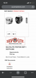

Just got the rings guys. Here’s the part numbers for the ones who wanted to know. To be more specific, these are for a .060 over piston (total bore 3.74 inches), the ring sizes are 1.5 mm, 1.5 mm, 4.00 mm and the groove depths are as followed (called the direct manufacture for every measurement):
Groove depth:
1: 146 thousandths
2: 171 thousandths
3: 196 thousandths
I’ll attach a picture below of which pistons these are for.
