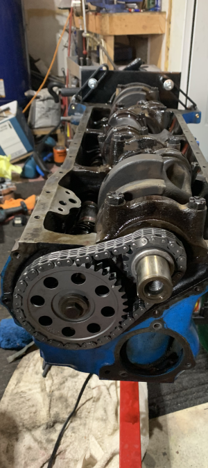

Your timing marks are correct, hard to see the dot on the crank gear, but timing marks do line up with the keys.
With no increase in compression numbers with oil in cylinders, I'm still leaning towards incorrect rocker adjustment.
If you did a 'zero lash' +3/4 turn on dry lifters, it is very likely you are over lashed.
Factory manual specs for adjustable rocker on hydraulic lifters, you should be at 0.067"-0.200" lash measured between rocker and valve stem tip with the lifter in a collapsed position.
Zero lash on dry lifters would never let the valves fully close, and could possibly bend push rods.

So with the new timing chain set as per photo. The cog on the cam has the groove so is set position and the the cog on the crank has the groove that line up with groove on cam. I did that as per instructions. (I didn't degree it, as thought with these markers it was a set position) The cam is the original.
Is the lack of degreeing the cam causing the issue? Can I do anything with timing etc to get around this problem? Or do I have to strip down to degree the cam??
My laptop is on a 32" TV screen. From my view, the timing marks don't look aligned. Probably the camera angle, etc, -and this is just a comment, not a controversy. . (Does cause me to reappreciate gear drives where the dots are in each other's laps. )
