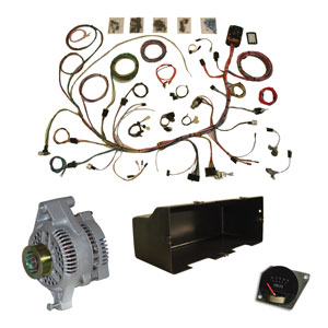

At this point my 'pink resistor wire' must B brwn ('70, or 55 yrs old). At least there's a brwn where the pink should B. It's all pretty confusing to me. Probably dont wanna (skull too filled up already?) learn either. Even for my 'dreams'. Just the financial out lay is a hump for me to get over. Also upgrades I'm tryin: DSII is in, Mini starter, G3 (both likewise), H4 headlghts, 2 batteries, winch, sno plow, smoother engine bay (no regulator/starter solinoid, also done) - possibly spool welder'n air compressor. Might start over w/harness that adapts (removes everything/start again) my old to new altho I have added in just the 'new' lill pieces to my 'old'. Then 'the rest' (beyond above list) just dont think others complete this way (like a inverter for a 110 plug to run grinder or wood wrkin miter box)...
