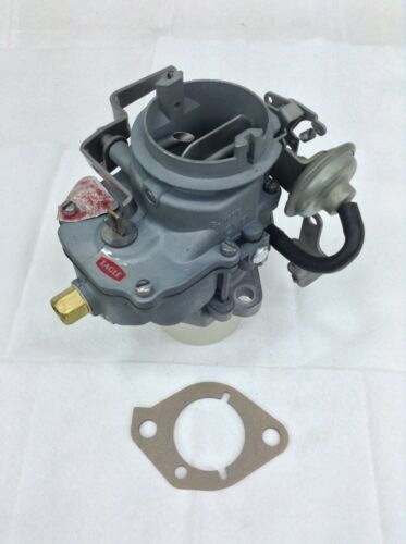

Last Carb Picture next to the Carter RBS is the Late 200 six Holley Carb about 1981 to 1982
