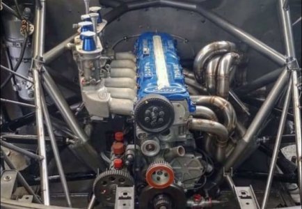

If you want something unique, then go for one of the Australia sixes. We have a 250-2v, a Crossflow head, a SOHC and DOHC Barra. Your 300 and 250 logs are very inferior to them. Just as an example a 4 litre barra NA is 195kw, thats almost 270bhp, i doubt you could get a 300 to do that without compromisings its drivability, even the SOHC 4litre was up to 172kw. You must have seen this:-RIMG0044.JPG

Australia has no match for the Argentine ACTC 24 valve DOHC head that will bolt onto a Falcon high starter six.
I don't see any Australian Ford sixes racing on the Argentine ACTC circuit which can draw up to 50,000 fans per race.

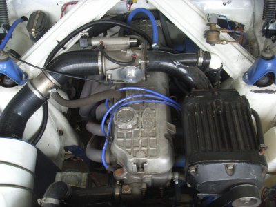

I think this is the 200 six conversion you mentioned.
This could possibly give some fresh ideas about an OHC design for the 240 or 300.

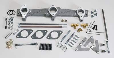

"I know you were looking into a tri-carb setup back in 2023. It would look so cool having such a setup. It would certainly draw a crowd at car shows."
250' Comet with Tri-Power Holley 1904's may not be the fastest at the track , but may be funnest . Enthusiasts of all kinds typically engage me in animated six performance discussions at cruises and shows.
hav fun
Honestly, the 200 six is a neat engine. It has a much shorter deck height than a 250 and 300. My understanding is, there is enough hood clearance for a tri-carb setup when used on a 200.
A tri-carb setup on an inline six would be a great thing to see at car shows. You will have more people interested and wanting to talk to you about the setup. Most people are bored seeing V8’s. Lots are looking for something different to look at.

The problem is, a 250 has about a 1/2" of clearance between the top of the air cleaner and the inside of the hood. There is for sure no way I could pull of an Offy 3x1. At the time that I started that old thread, I wasn't aware of the lack of clearance yet.

A 200 with a turbo can be pretty fast and you can set the boost at level which may not grenade the engine to quickly and would certainly be easier that a 300 swap.
