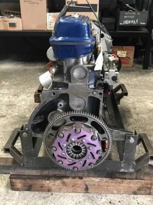

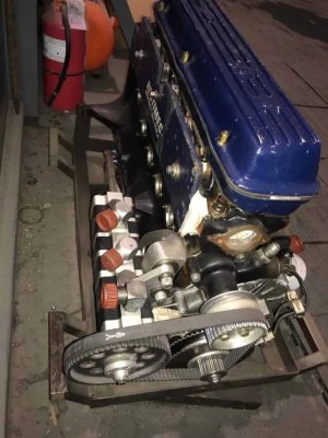

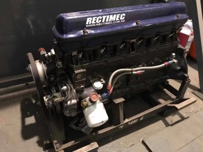

The 3 liter 24 valve DOHC version is limited by ACTC rules to 9,000 rpm and 500 hp.
The old push rod roller cam 3 liter ACTC high starter Falcon six engines produced 380 hp at around 9.000 rpm or more.
