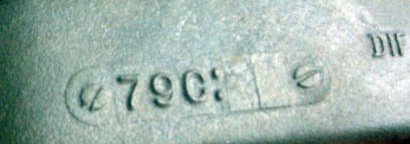

so short block is at least a 1968 to know the true year of the engine you would need to find the Casting Date Code which looks like a small metal plate in the casting (see some example picture's below) it has a Straight Blade Screw Head at each end it will 2 or 3 numbers and a Letter on it.
