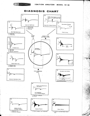

If you were near by I'd loan you my Heathkit IO-20 ignition analyzer...about 65 years old and still works great.
No...haven't had the opportunity so I can't say for sure if it would work. I know that it works on non-distributor engines...you just don't hook up the primary wire clamp. Most of your needed info is seen from the secondary hook up anyhow. You can check each waveform from each cylinder separately or with non-distributor engines you would need more clamps...and wire them all in series to display a parade pattern. For the old style distributors...you just clamp on to the primary coil wire and clamp on #1 plug wire and you'll see a parade pattern.
I don't know enough about multi spark....I'd guess you'd just see a different pattern and then would have to get info from the manufacturer to analyze the waveform.
