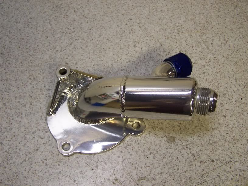

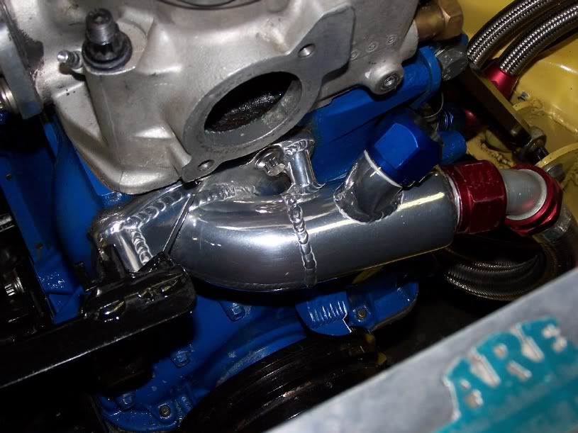

Because our Aussie X-flows and 2V 250's and US log heads run the same thermostat neck, you just need to copy what Our Aussie Six cylinder Cortina and Falcon guys do. They are always having the same problems as early Round body Falcon owners when a 250 six is put in.
Cyco 250 on http://www.xfalcon.com/forums/index.php ... d-cortina/
http://i255.photobucket.com/albums/hh12 ... 0_3282.jpg
http://i255.photobucket.com/albums/hh12 ... 0_3328.jpg
See and do a search on balldrick's 1960 XK Falcon. He runs a Davis Craig electric fan.
http://fordsix.com/forum/viewtopic.php?t=56560
http://i185.photobucket.com/albums/x180 ... xkeng1.jpg
http://i185.photobucket.com/albums/x180 ... ngmoc3.jpg
On the X seies Falcon forum for 1960 to 1999 x-shell Ford, the Cortina owner is Cyco 250 on http://www.xfalcon.com/forums/index.php ... low-story/
Each show easily made Davis Craig/EWP electric water pumps which work really well when the instructions are followed.
