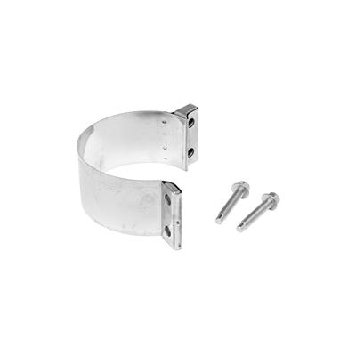

I like Butt Joint clamps (also called Band clamps), which can be purchased from Summit Racing for about $9 bucks each. They don't wear out (or leak) like flange gaskets or donuts.
