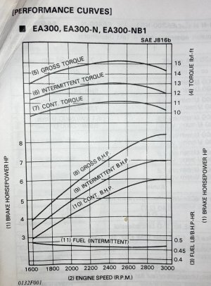

Performance Curves
Note: The mil. spec’d EB300 engines are deliberately underrated on what they actually produce. The graph below shows a truer performance curve of what the EB300 actually produces.
The EB300 engine speed is set to 2657 RPM This brings the voltage frequency to 62 hz with no load. When the generator is loaded to 3,000 watts, frequency reads 60.3 hz.
I posted this chart earlier:
It turns out that the engine runs right near peak performance curve on the chart above.
