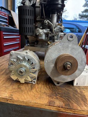

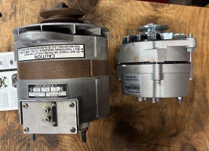

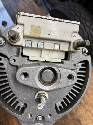

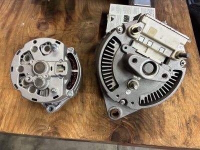

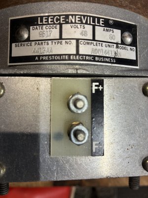

And to power the inverter it would be something like the alternator below. A Balmar type charge controller will be needed.
Size comparison:
Next to a Delco 10DN
