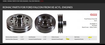

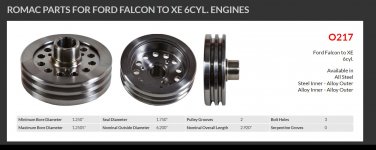

On page 18 of ''Ideal 200'' top of small six forum, there is some Romac balancers, the 200 is 1.250'' looks like 0222 would fit, check it out.
Edit, looks like 0217 is a better fit.
Dimensions for 0222 and 0217. Only differences are highlighted. Bolt holes 3 to 4 and Nominal Overall Length 2.920 to 2.630.

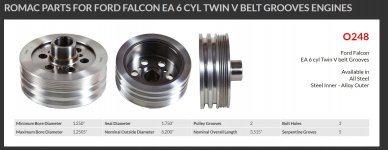

There's a post on this forum that addresses the same issue:
The balancer for the EA SOHC has similar dimensions to the 0217 listed above plus it has a 5-groove V-belt pulley.
Just what one needs for a supercharger.

I did consider this when I did the blower on mine, but, I doubt that 5 ribs will be enough to drive a blower. I've got an 8 rib belt on mine and I get some belt slip above 12psi and over 3000rpm. If I clean out the belt grooves I dont get slip for a short time. I use the slip as a safety factory, (stock, old bottom end).
