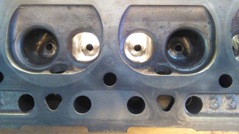

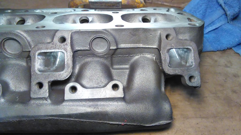

Silver sharpy outline of the exhaust gasket holes. I didn't go out all the way to the edge, read it's better if the head side of the ports is a little smaller than the header side of the ports. Seemed good to leave a little meat on there as well. And 4 or 5 hr's was after already doing this to another head then finding a crack 2/3 through getting it ported
So I had a little practice already. Btw, Chad, I looked and I used 60 grit rolls on the intakes and 60 then 120 on the exhaust side. And fyi, they were the "premium" 3m rolls, tapered 747D's
