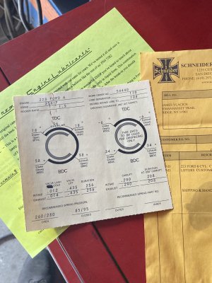

I had my 223 camshaft reground by Schneider about 12 years ago. It runs mint, has a light hotrod thump at idle and just enough vacuum (17@ idle) to keep things moving. I’ll post a pic of the grind card specs later today. Highly recommended.
