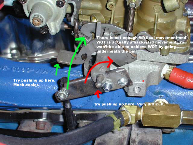

That solution won't work for this carb - trust me. If you look in this picture, http://www.albertpenello.com/mustang/throttlearm.jpg, you'll see the original throttle pin in the center of the linkage. That pin was designed to be pulled back, not pushed up. You'll have the wrong angle if you try to push up on that pin. Also, that pin is placed farther forward of the existing linkage (in your picture you just needed to RAISE the linkage, for this carb you have to raise it AND move it forward), so you'll have to fabricate an "L" from the throttle arm to make it work, which will be more complicated. And when you make it fit it won't work properly anyway.
Just replicate what I've done - it will be easier. You have to move your leverage point outward to be able to push up on this linkage. I can't describe it any better than that picture. Make a plate with two holes that you can screw into the existing holes on the carb. Make a hole out a couple of inches and put one of those posts on it, screw it on, and hook up the existing linkage. It should work fine and took about 10 min to fabricate. If your aluminum is bending, then you're using too thin of a piece. Get yourself a sturdier piece of metal. :D

Slade - don't get me wrong; I wasn't slamming you. I was just saying that solution wouldn't work in this instance. 8)
TheDude - you can try it, but it's not going to work well. I just looked at the car to confirm and I think it's a mistake to go this route.
That linkage post is too close to center to make an up/down movement. You're too close to the fulcrum - it was designed to be pulled back not pushed up. And you won't have very much vertical play to you're throttle is going to be very sensitive.
If you don't believe me, put your finger under that knob and try to push up. It's VERY difficult and it quickly reaches the apex before wanting to move back. I don't even think you can get full throttle this way.
Also, that post is too far out - the way I did it I have the post on the extension facing towards the engine to bring the throttle back to it's natural vertical postion.
Look here:
Save yourself some time - I went through the trial-and-error already. It takes less than 10min to fab up what I did.
In your application, does the vertical rod contact the tab (the one the little green arrow is pointing to) directly and push up on it? Thanks for the help. :wink:

Sorry for interrupting but no, TheDude, I believe the tab you are referring to is a part of the carburetors throttle arm. It rotates with the rest of the throttle arms assembly.
