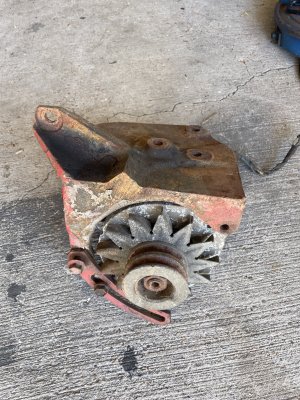

No but a 250 alt bracket will not attach to a 200 if that is what you intend. At least I could not use my 200 alt bracket on my 250 when I was upgrading. I had to find a 250 alt bracket.

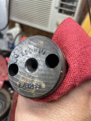

Had a question about the camshaft if anybody knows how to give me the quick and dirty: I want a completely stock cam for my 250. The camshaft that I currently have has an interesting lope to it that runs super quiet at high rpms, but sound like it's going to die at idle (exaggeration). It looks a 260H. Don't know if that's a performance profile or not. Maybe just a bad carb setting. I don't remember much else about it since I hadn't driven it since high school. Can someone let me know if this 260H-10 is stock or not?

No it is not stock, it is a Comp Cams 260 degree hydraulic high energy cam. It will not idle like a stock cam. But will give good torque and power.
Okay. I don't really need either of those things. It's a convertible. I'll have to look for a stock one. I'm just wondering if you can even find stock stuff anymore that's not pitted or abused. Found one on eBay listed as stock but I don't necessarily trust eBay implicitly. Maybe I should keep the current cam so that I can drive pretty well at freeway speeds. I remember that it was really good at that.
My dad always thought this was a boat motor. Wonder if that could be true with this cam.

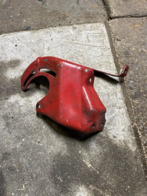

Thanks for the suggestion. I may be super needy here, but does anyone have a picture of the following bracket actually mounted on the car? Having a hard time finding a picture of it.

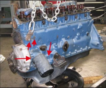

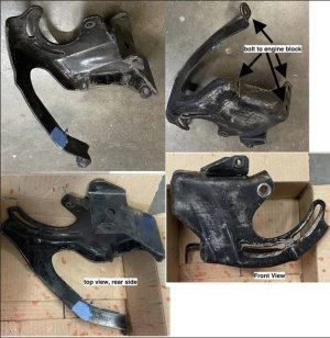

Okay, so I did find something about this bracket. I'll post it here just as information. Found it on Vintage Mustang site. I believe this is the same bracket.
