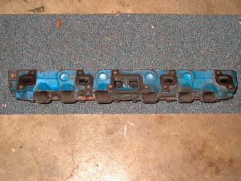

actually once the flange is machined off like in the picture, you have a great outlet for the exhaust since you eliminate the severe downturn of the stock flange.

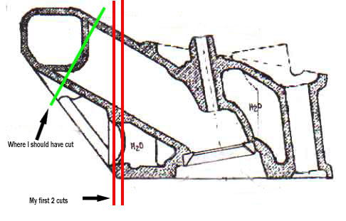

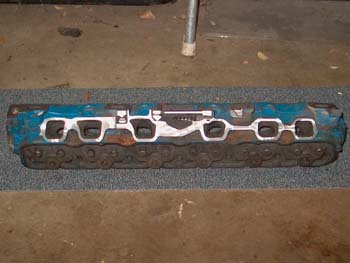

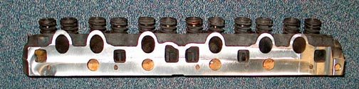

The C1 chop. This cut was bandsawed and then cleaned up, all the way across. We took about an 1/8th of an inch too much I think.
With an early C1 head, it probably would be best just to skim the log off, only;
C1 head chop pics:
#5 in. + ex.

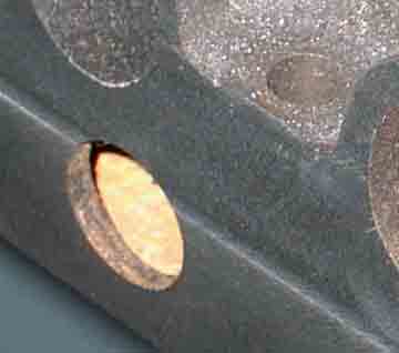

Core plug hole.

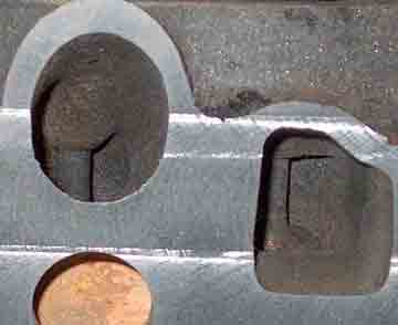

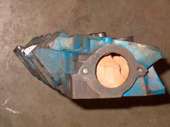

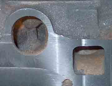

The D7 head chop. Cut off the log only, leaving the exhaust untouched. D7 intake ports are all goofy amoeba shaped, kind of random. Maybe we should have carefully milled at a 90˙ angle to the head face to get down to a more consistent cross section (but, we didn't). A straight across chop, like the C1 cut may have resulted in a usable head... maybe. I picked up the 250-2v head at that point in the game and the chopped heads went out into the core pile.
Pics:

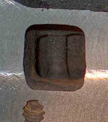

chopped C1 ports vs 250-2v ports, or, why I stopped chopping up log heads.
2v top, C1 bottom - intake:
2v top, C1 bottom - exhaust:
