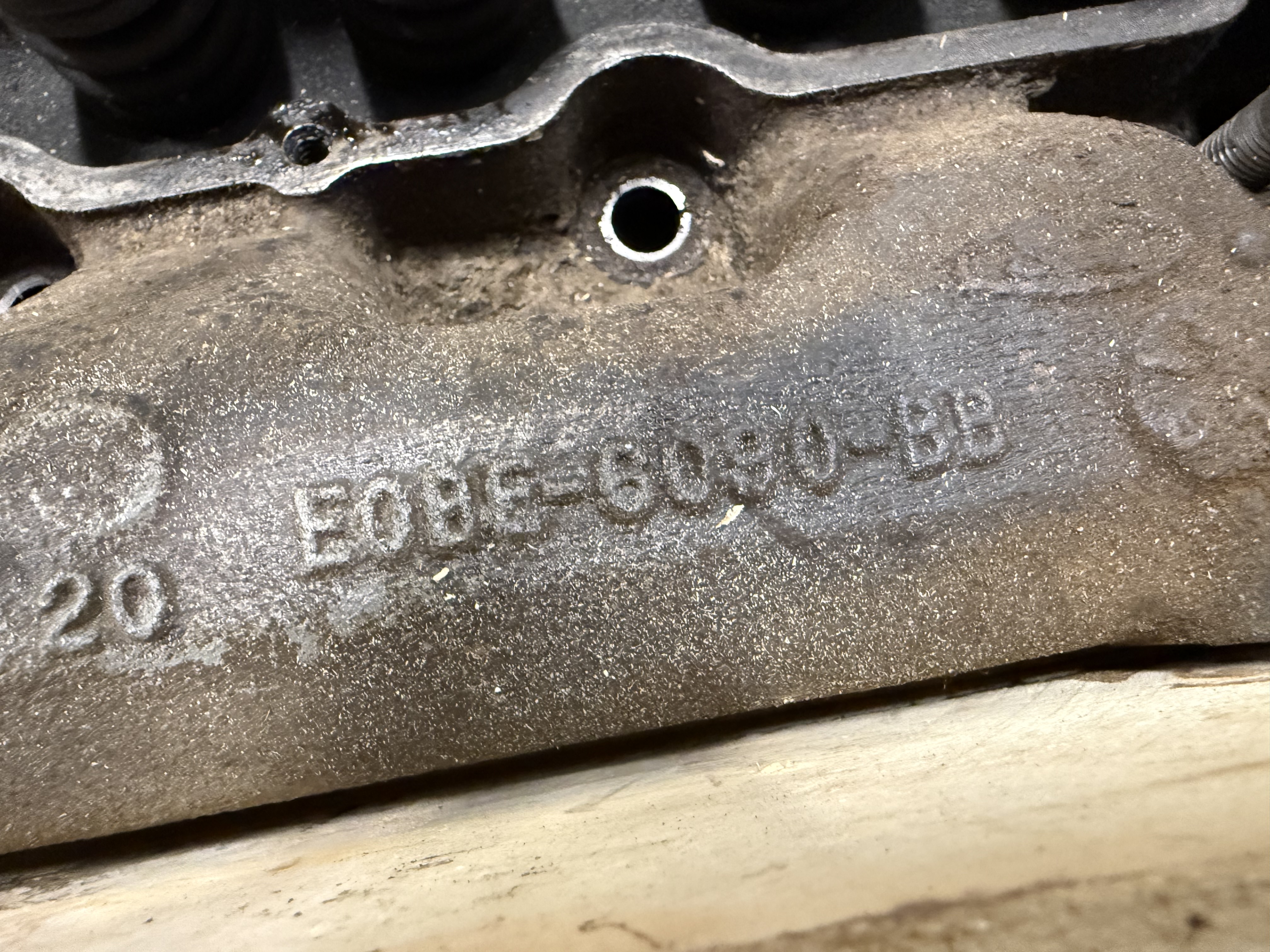

So long term this car will get a V8, but I decided that I want to play with the inline 6 a bit first.
My 61 Falcon currently has a 1978 200ci block and a 170ci head from a 1961 (could be the original, I don't know).
My plan is to machine the log to accept an adapter so that I can run the Holley 2300 flanged Sniper kit. So I bought this to do the work on.
This is a 200ci cylinder head from a 1980 engine. It should have the largest log. Now I'm trying to decide what to do with it, maybe just straight rebuild. Should I shave it down some to give it a compression bump? I don't mind running premium if it means I get a few extra horsetorques.
What is the static compression ratio of the 200?

Yep largest log like 1420 cfm, big valves all the good stuff. Good find. You could machine for the adapter or mount a Carter BBD 2v or Rochester 2v, with adapter right to the carb mount it has now. Nice shipping crate.

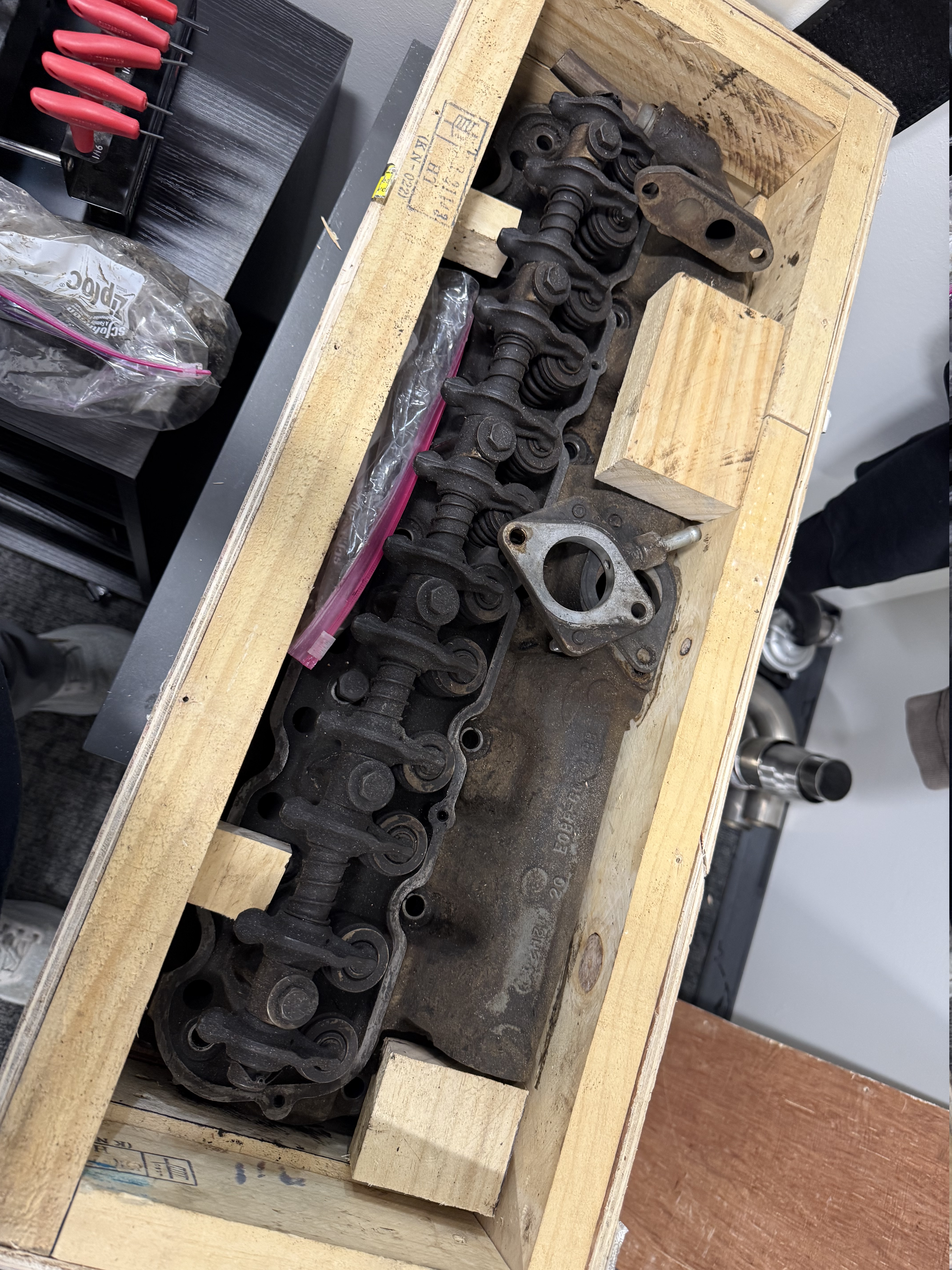

The guy that sold it to me made that. I was impressed too! 97lbs was a spendy package to ship!
Nice score. Big valves and big log to help get fuel and air into your engine. Really nice packing job too.
