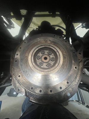

My car is a ’66 Mustang with a 200ci engine, currently running a ’78 block and a ’66 head. I’m planning to upgrade to a 250ci ’69 M-code head later on — I already have it, along with new valves and adjustable rocker arms.

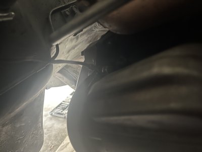

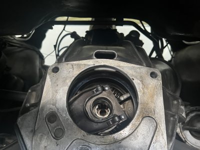

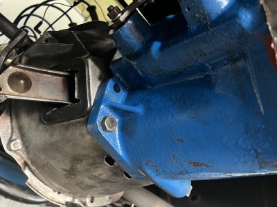

The current transmission is a 2.77, which has been rebuilt multiple times and kept failing. It’s finally coming out. Most recently, I barely managed to get the car back into the garage in second gear — the transmission is now stuck in second and won’t shift at all. That made things a bit more complicated since I couldn’t really drive the car anymore, not even out of the garage.

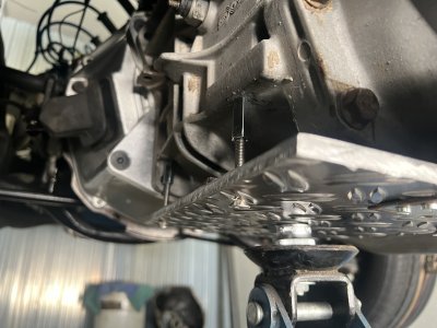

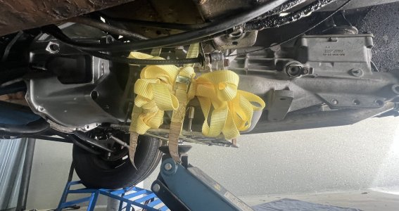

So I got myself a heavy-duty jack that can lift over 60 cm — an absolute beast
— lifted the car, put ramps under the front wheels, and placed jack stands in the rear. On top of that, I secured the front with ratchet straps over the tires and ramps. I may not be the youngest anymore, but I’d still like to stick around for a while

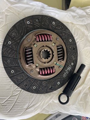

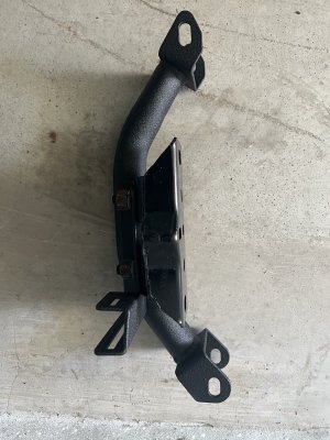

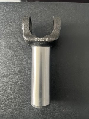

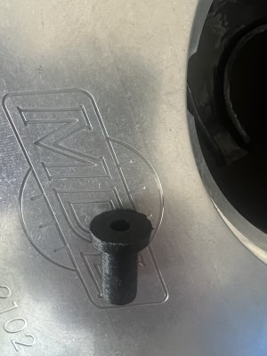

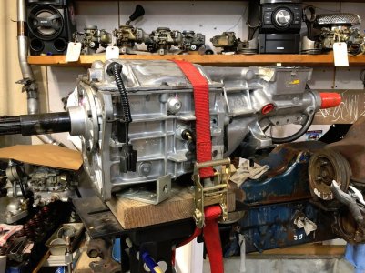

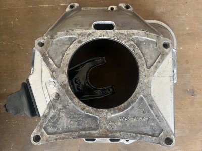

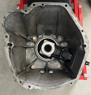

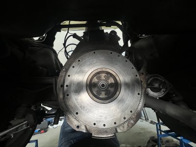

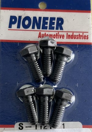

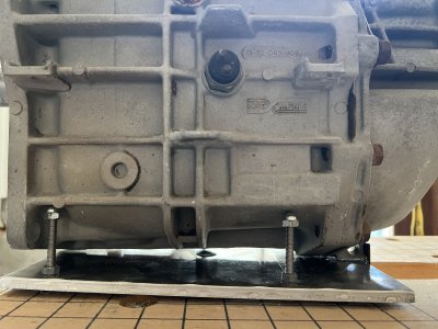

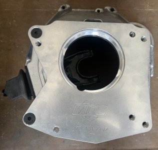

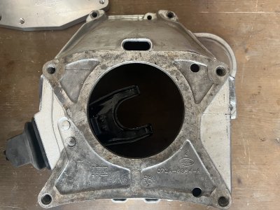

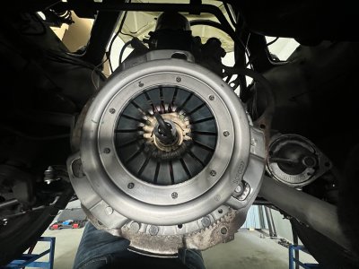

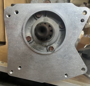

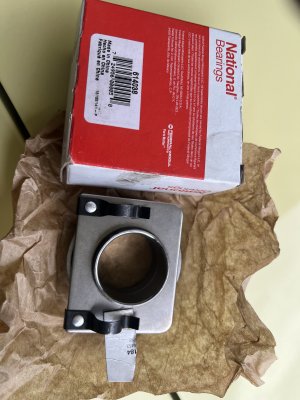

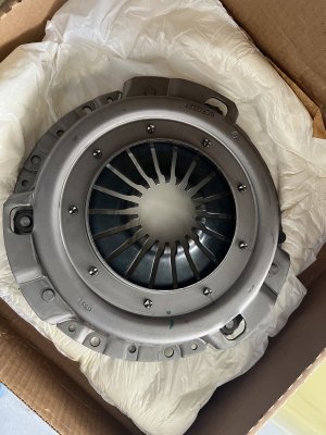

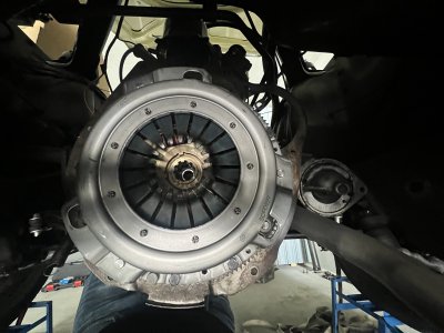

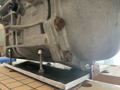

For the swap, I’m using a T5 from an ’87 Mustang, a clutch from a ’78 Fairmont, a pilot bearing from a diesel Explorer, a throwout bearing from a ’68 Mustang, and a bellhousing from a ’67 Mustang 6-cylinder. Since I have the small driveshaft with 1100 U-joints, I also needed a matching yoke, which I could only find at Modern Driveline. That’s why I ended up sourcing the other parts like the adapter from them as well.
