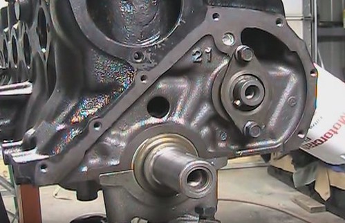

New 200 Build - No Oil Pressure
Sorry LR of head. Nothing to do with your current problem.
If the plug behind the timing gear is missing that is the main oil galley that feeds everything else.
Bite the bullet & pull the timing cover & the camshaft gear & you will see the problem.
Either tap the galley & install a screw in plug, or install a deep cup plug with permatex & stake the block in 3 places around the plug. To prevent it from coming out.
Did you install the main bearings correctly? Are the cam bearings installed correctly?? Best of luck.

Thanks for the follow-up. I don't know what else it could be besides the front plug. I know the cam and main bearings are installed correctly. The mains were installed in the video I did. The cam bearings were done by the machine shop. (Hopefully good). I'll let you know what happens. I have the radiator and condenser out of the way so I can pull the pulley and remove the cover, hopefully tonight. Fingers crossed this is the problem...

I guess my machine shop guy should have put it in? Don't really matter now...
Hard to see in your video, I can not tell for sure, but I think it is missing...But it does recess some...Definitely not sure. :?:
Where is your video--what is it titled? I hope you get resolution soon--I'm no stranger to frustration! Today when I put my rebuild in, I didn't have an electric drill to spin the oil pump, so I did it manually with a socket wrench, and it STILL pumped oil all the way to the rockers. So thankfully no problem there for me. BTW, did you try removing the oil pressure sender and see if oil comes out when you spin the pump?
Is this the hole that should have a plug in it?
Does anyone have a picture of the front of their motor before putting cam and timing chain on? Knowing what size plug to get would be a big bonus too!
:bang: yeah that's a shame but at least you found out before anything bad happened. :nod:
X2 Yes it is, sorry no pics....the hole I get .438 and a used knock in plug I get .442..7/16" is .4375....The edge of the plug is recessed back about 1/8" to 3/16".....

I've confirmed... the plug is missing and NEEDED! I plugged the hole with my finger, turned the oil pump with my drill super slow and was able to get 5psi of oil pressure.

I had the same issue on my build. Being a newbie I didn't know what to look for nor even know what oil journels were. We did the electric drill trick to test before installing and no pressure. Not only was the front one missing, the rear one was too (FYI, it did NOT pour oil everywhere with the drill test). We looked in the bag o parts left over from the build kit and there were these two tiny shiny round things. Whew! Lucky for me I had experienced friends helping me. It was a pain to pull the front apart to install the plug (back no access issue) and reseal, but better than having to pull the engine / tranny to fix and/or ruining a new engine. Good judgement comes from experience. Experience comes from poor judgement. :P
