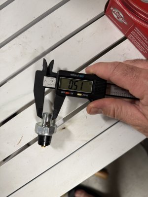

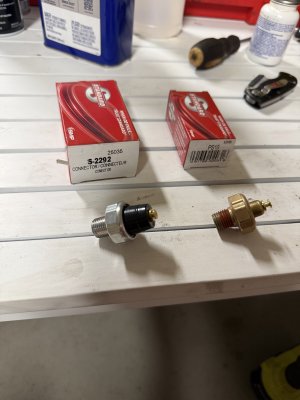

In the attached picture on the left is the same sensor that I had, prior to removing it. I cleaned the threads inside the engine, but the new sensor just wouldn’t go far enough.

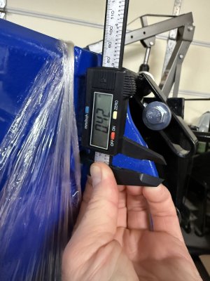

Now that I’m writing it, I understood that I didn’t measure correctly (measured the sensor threads outer diameter above the threads and the inlet diameter is measured past the threads), but it doesn’t change that I can’t screw it in and don’t want to force it too much.

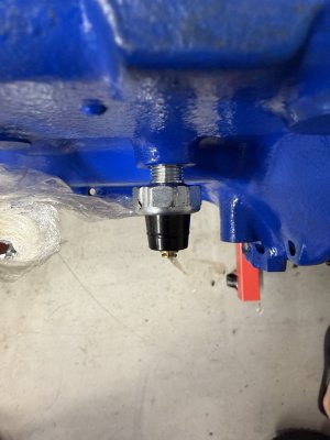

These threads are usually pipe threads which are tapered. Get a thread gage and measure the pitch of the threads of the old and new. If they are the same carefully run a pipe tap in the hole to clean it out. With todays parts the quality control is not what it used to be.
Take the parts to a hardware store and try them in pipe thread fittings and see how they fit.
Hi, how did you "clean" the threads? Ford cut 1/8" pipe threads, which are tapered, and if you did not use a 1/8 NPT tap, or turned the correct tap in to far, the sender will not seal. Let's see what you did, and figure out a solution. Good luck
I didn’t have NPT tap, so a cleaned it with metal picks as much as I could.
I’ll pick up npt tap for this then. Thank you!
Try ''falcon parts .com'' $14.95 says it is for oil pressure light for 6s and 8s 1960-1965.
Yes, looks the same as the one I have 👍
Thank you! I guess it is the right part, just need to clean the threads better

This is as much as it can go in. To thread more - I’ll need to put more force, which I’m a bit skeptical I should be putting to thread it in
