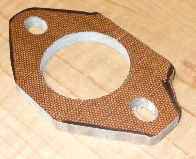

Has anyone made one and put one on their car?
I made one and so far it seems ok for the one trip around the block.
My thought on why I made one was to reduce the heat being transferred from the manifold to the carb. Mine is 1/4" thick made from phenolic sheet I bought from Grainger.
