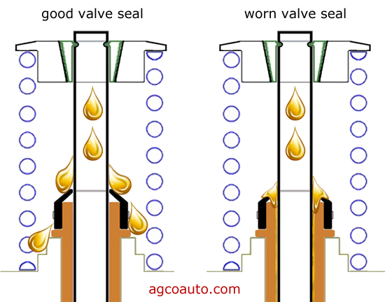

Noticed my valve seals were not umbrella or viton. They are some double o-ring things. Do these belong on a ford? My grandpa is convinced they don't belong there and he's rebuilt and overhauled several of these motors in his day
It sounds like they used the wrong valve stem seals. The seals should be the umbrella style (pictured in a previous post to this thread). Viton is type of material, the stock type are made of rubber. Ones made of Viton should seal better, but either way the "umbrella" should shroud or cover the entire valve stem 'boss'.
If it doesn't shroud the entire boss then you can experience oil entering the cylinder between valve stems and the valve stem guides...
72maverick":16nvgsx3 said:
So this could explain burning oil
http://mgaguru.com/mgtech/engine/pics/vseals_b.jpg
it looks like the one on the far right
of Those in the pic I prefer any of the 3 on the right. Never really liked the Teflon seals on anything. (Machining & special install tools,.....)
I have seen those type of seal run with out the bottom metal spring when it doesn't want to grab the lower guide boss tight. THan what you basically have is more like the stock type of seal.
Now they could have install new seals but have some "New guy" assemble the heads and then if he doesn't set he travel correct on the valve spring compressor then he mashes the seal (which cuts it) in between the retainer and guide boos. Then it worse than having no seals at all.
Also it is possible to be using oil and smoking bad and the plugs be as clean as a pin. This happens when the bad seals are only on the exh side and the oil doesn't get into the chamber but only into the exh system.

72maverick":2dislvlg said:
My grandpa thinls the umbrella types are the only type to put on these motors
I agree with him. However any in that pic are "umbrella style" seals compared to the Brand "C" O-ring seals.
:unsure: In my Opinion those seals also work excellent (have used them as well as the umbrella type in many rebuilds) if they are in good condition as the picture shows they would not be the cause of your smoking.
Probably not gasket or guides though to 100% rule them out would require taking it apart for measuring and inspection. Its looking more like it would be the rings to me. :nod:
