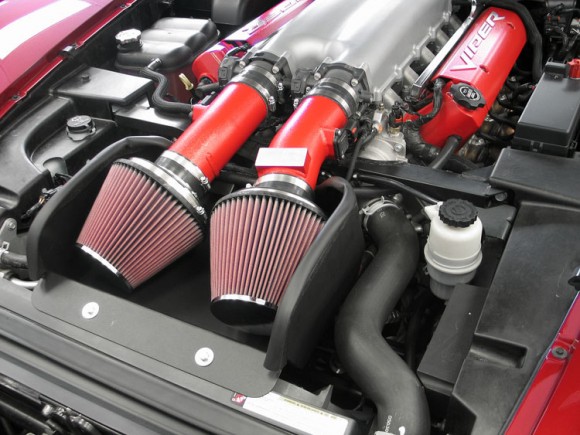

One other thing. I admire your Classic Inlines dual snorkel intake. Are the K&N Filters the RF 1048 like this

They are a standard aftermarket Viper 8.4 set up

The twin k&N's, on anything in particular, but certainly the Viper, always look to me like a Giant Crab Spider ready to pounce...
