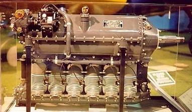

I was surffing the HAMB and found this photo of a sprinter circa 1952 with an inline six. It was powered by a Ranger six, which was, I believe a helicopter or aircraft engine. Correct me if I'm wrong. I liked the lines and proportions of this machine.
Could be. The Fairchild 440 was used in airplanes and helicopters. OHC 6 cylinder, inline, air-cooled, 440ci, 175hp@2450rpm, 376lbs. It was used in a lot of trainers like the Fairchild PT19. In the airplane it was run inverted as shown in the picture.
