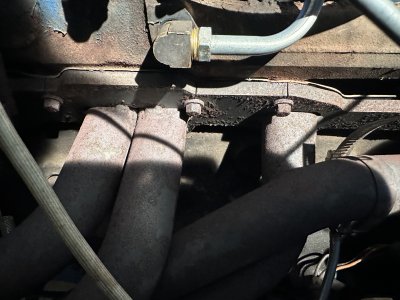

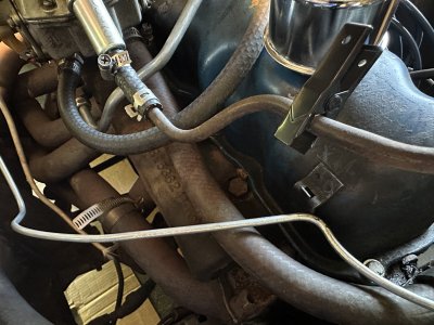

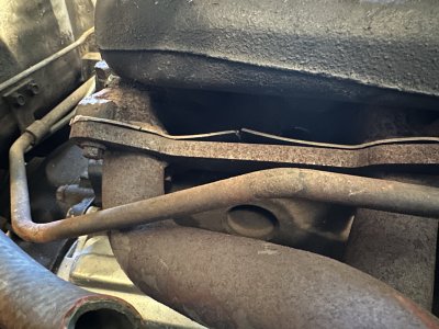

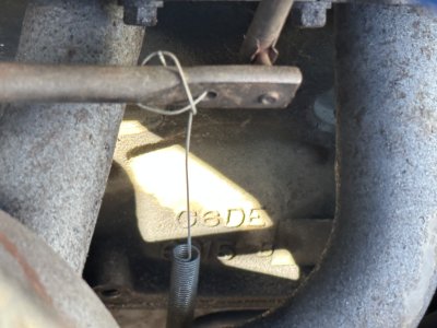

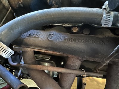

Got it that’s what I’m worried about but having a hard time telling if I have an exhaust leak, should be pretty noticeable. I’ll add some photos here

Looks like you have headers. The ports would have been on the original exhaust manifold. You should be fine 😎

In your fourth picture here, just above the C6DE-6090 on the intake log, I see two hex heads. The dark one above the 6090 looks like a head bolt. What's the shiny one above the C6DE? A plug for a Thermactor port maybe? Are there five more of them along that area? The pics don't show that part of the head clearly. The handbook seems to state that the part numbers are the same for Thermactor and non-Thermactor heads. But they say to avoid them, so they must be different. I wonder if the air injection ports are machined in later and aren't actually in the exhaust manifold.
Okay, I spent a couple minutes on google while eating breakfast. Saw mostly 289 pics but I didn't look long. Ford actually made a hex-head plug for the ports when a Thermactor system was removed. The "injectors", not sure what they're called, were pressed into the head, and protrude into the port. That's why they are frowned upon for performance applications. Pull your headers off and you could probably see them way up in your exhaust ports. Maybe they could be machined out with the head removed, and a nice flush ended non-protruding plug made up so as to not disturb the exhaust gas flow.
