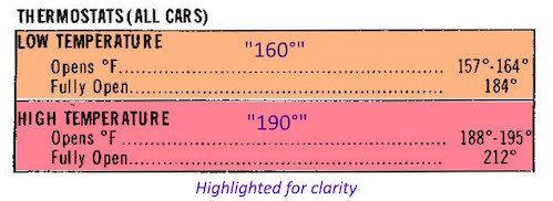

Below is a copy of the Ford graphic, highlighted for clarity between the two alternate temperatures:

Yeah, it's surprising how few have looked at that part of a manual, but then again most do not reference the FSMs, and the graphic is not clear. The assumption is that it should operate properly at either temperature. This is not inclusive of other uses, such as Ford marine engines using 140°F thermostats.Good to know that the 160 is listed in the 3.3 service manuals .
