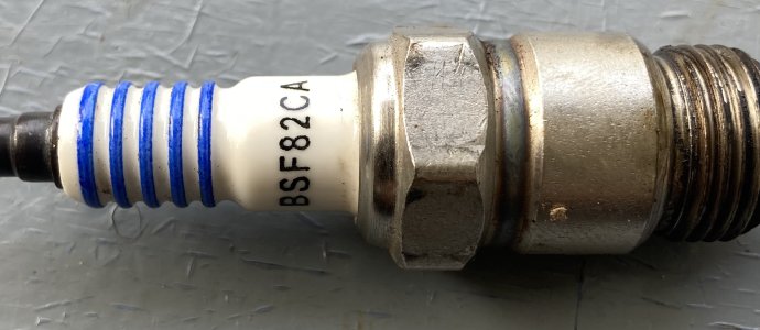

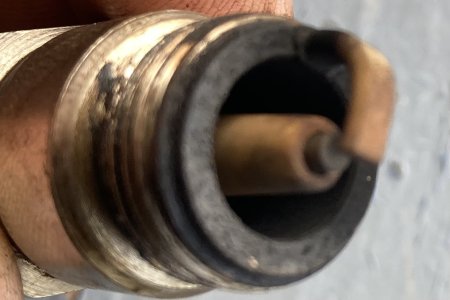

Last time I had the plugs out was with the 70 jet and they were black. Since then it’s done 40 miles with a 67 jet and 4 miles with the 65 jet + idle and such for adjusting idle etc

I'm new to using an AFR meter also so I can only offer limited help. Your numbers seem a bit low; what can you achieve running at a steady speed at light throttle on level road?
Also, how are you operating the vehicle before you pull the plugs? When I tried reading plugs, I would drive at a steady speed and then turn the ignition off and push the clutch in at the same time and pull off the road coasting, then pull the plugs.

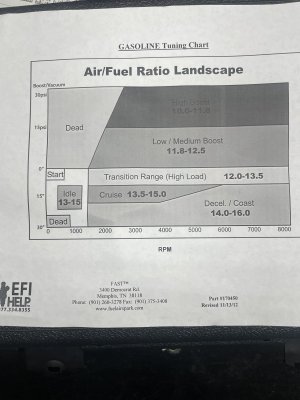

This came with my meter and have found it helpful as a guide. For high speed reading, was told to run wot for 30-45 seconds. Idle you can learn to tell where your particular engine is “happy”

The plug looks slightly rich but close to good.

Things still point to the gauge is off. 11:1 is really fat, the plugs don't look that rich on the pics. Plus the reality that, if it were 11:1 it would stumble on throttle-off from going flooding rich through that short vacuum transition.
