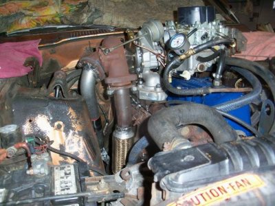

I'm a fan of low-boost builds to emphasize how a well built stock six can simply (inexpensively) achieve the equivalent of extensive NA build performance.
from old post:
... fortunate that a well put together small block six can effectively use a power adder even with 'cheap' setups. . 6 - 10 lbs boost may sound less impressive but here's a pic from the MacInnes book on Turbo's of an older Draw Thru "Kit" on a A 250. It claims at 3000 rpm - 90 RWHP without boost and 168 RWHP with 8 Lbs boost . Probly' bit optomistic but impressive .
