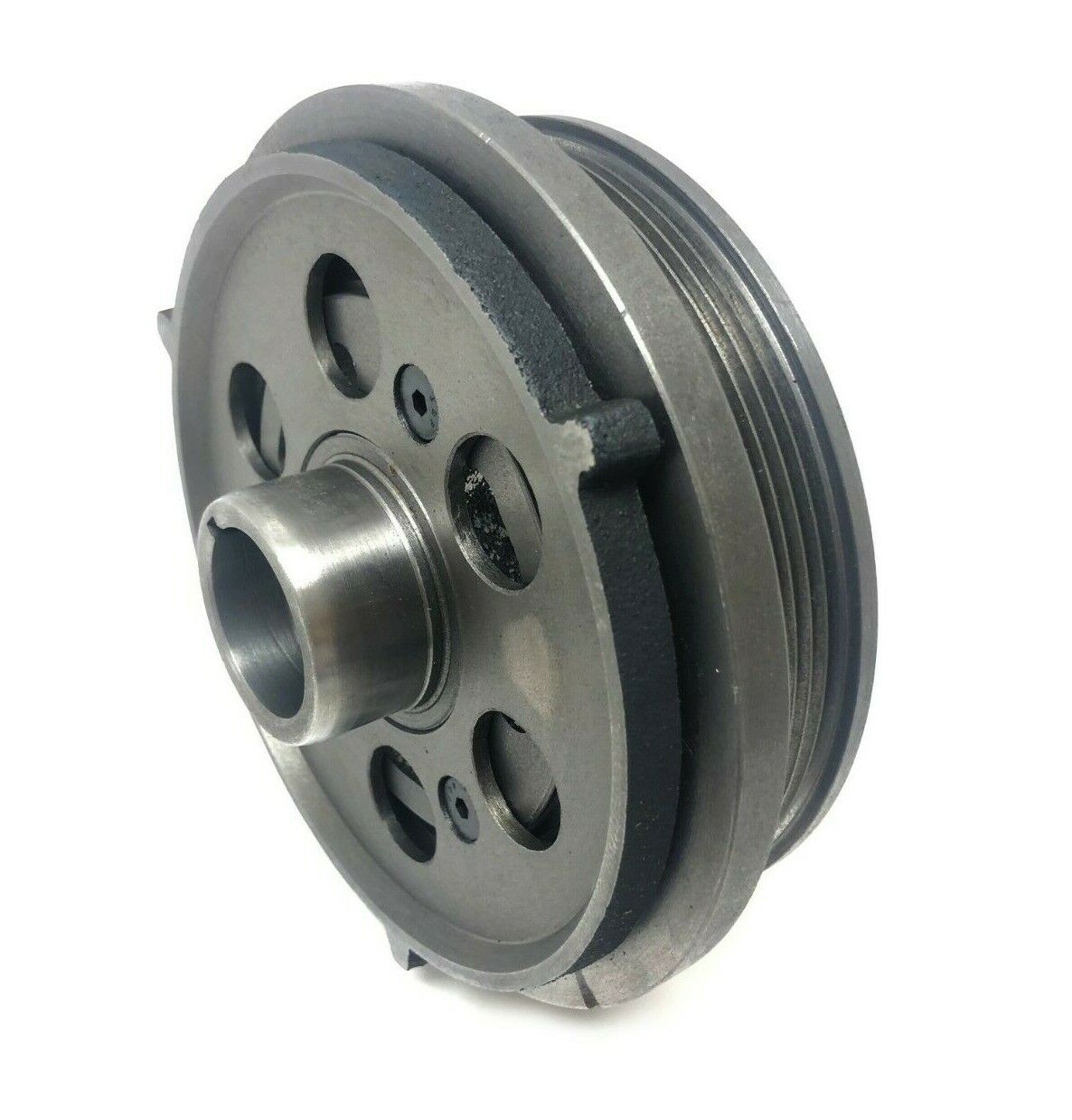

The 1996 Ford 4.9 harmonic balancer has a trigger wheel mounted to the back on the hub.
You would replace that wheel with a 60-2 trigger wheel.
You can use the 1987 to 1996 4.9 EFI distributor for the cam sync signal pulse by removing all but one of the vanes on the rotor and replacing the distributor cap with a round flat cover.

Holley EFI systems were having problems tracking the 60 tooth wheel at high rpm so they now recommend using the 36-1 wheel.
The Holley universal wheels are designed to have the center hole machined and the mounting holes drilled to fit the balancer, in this case the Ford 96 balancer hub.
First you figure out a good place to mount the pickup sensor.
Then the wheel needs to be installed so that when the crankshaft is at TDC, the sensor is pointing at the 7th tooth after the missing tooth gap (7 to the left of the gap)
SBC instructions as an example.
If you use a SBF ATI balancer, Holley has wheels that will bolt to them directly.
What will you need to drive off the balancer with a belt?
would that be a natural balance , sbf balancer to fit a bb 4.9 I6 Like a ATI that would be machined Already. Then the 36-1 wheel would be done. Would I then need to machine balancer at all to make it fit 4.9 engine
Yes, you would use the SBF balancer that is neutral balanced.
The SBF balancer is about 1/4" longer.
It can be machined to the 300 balancer length or left as is and use a little longer crank bolt.
If you are not driving anything off the crank then pulley alignment wouldn’t be a concern either.
