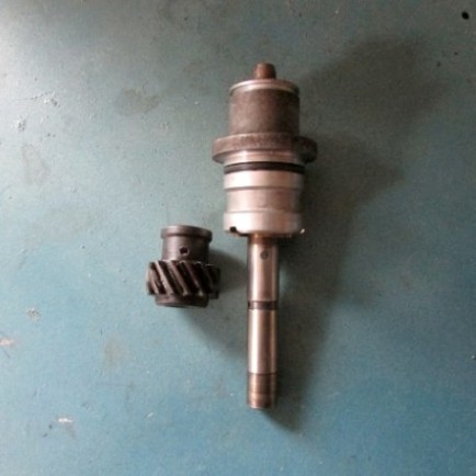

thesameguy":nfff8uld said:I went by the junkyard last weekend, and amazingly there were two '92 4-cylinder Mustangs there. I almost pulled the whole motor I was so happy (can't have too many 2.3l Lima parts around!), but instead I just pulled the oil pump drive.
Here is what it looks like removed:
Couple things are true:
1. The gear is different compared to a six. It's at least a different diameter, didn't bother counting the teeth.
2. The shaft size is the same between the two, but there is a crown on top of the six's gear that interferes with the body of Mustang part.
3. The shaft on the Mustang part is about 1/4" longer from gear to nose than on the six. The recess/drive for the oil pump shaft is about 1/4" deeper than the six's distributor, so it could lose some length.
Here's an image approximating the gear interference:
So.... I dropped the gear and pump drive off at a machine stop. They are gonna turn down the gear and trim the nose off the shaft. Hopefully that does it. I can't see any immediate reason why it won't.

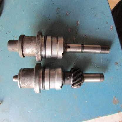

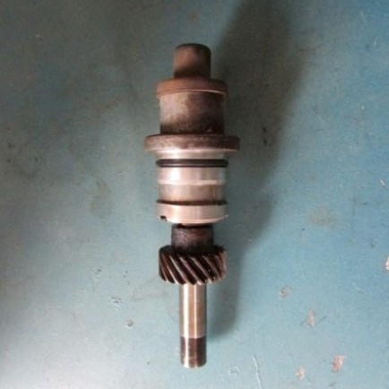

thesameguy":nfff8uld said:Got the oil pump drive back from the machine shop.
This picture shows the modified drive versus the original. Notice the top of the gear (post above) has been machined off, and the nose of drive has been removed. The 2.3l four is thicker than the small six here, so the drive is about 1/4" longer.

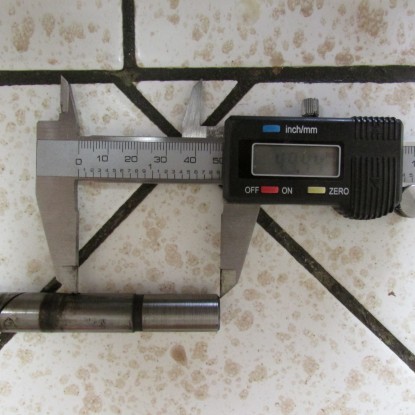

Here is the measurement between the tip of the drive the hole for the roll pin. This measurement is on a 200ci six distributor shaft with the gear removed. This is what you need to get the shaft on the 2.3l oil pump drive down to.

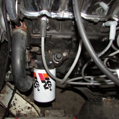

And, finally, here it is installed. Although a total anachronism, it just about looks like this motor was designed to have distributorless ignition from the beginning! I used the hold down from the 2.3l motor, as it fits much better of the drive that the stock piece. I had to hack it in half and redrill the hole, but it's a better fit and I won't have to worry about the drive floating out the block.
Only point of concern for me is that I got the gear installed properly vertically. Pretty sure my measurements were all good, but I snapped some pictures of the teeth on the drive gear and will check out wear in a while to make sure it doesn't need adjustment.
This project is pretty much DONE. I am really looking forward to many months of driving this car and NOT working on it.![]()
