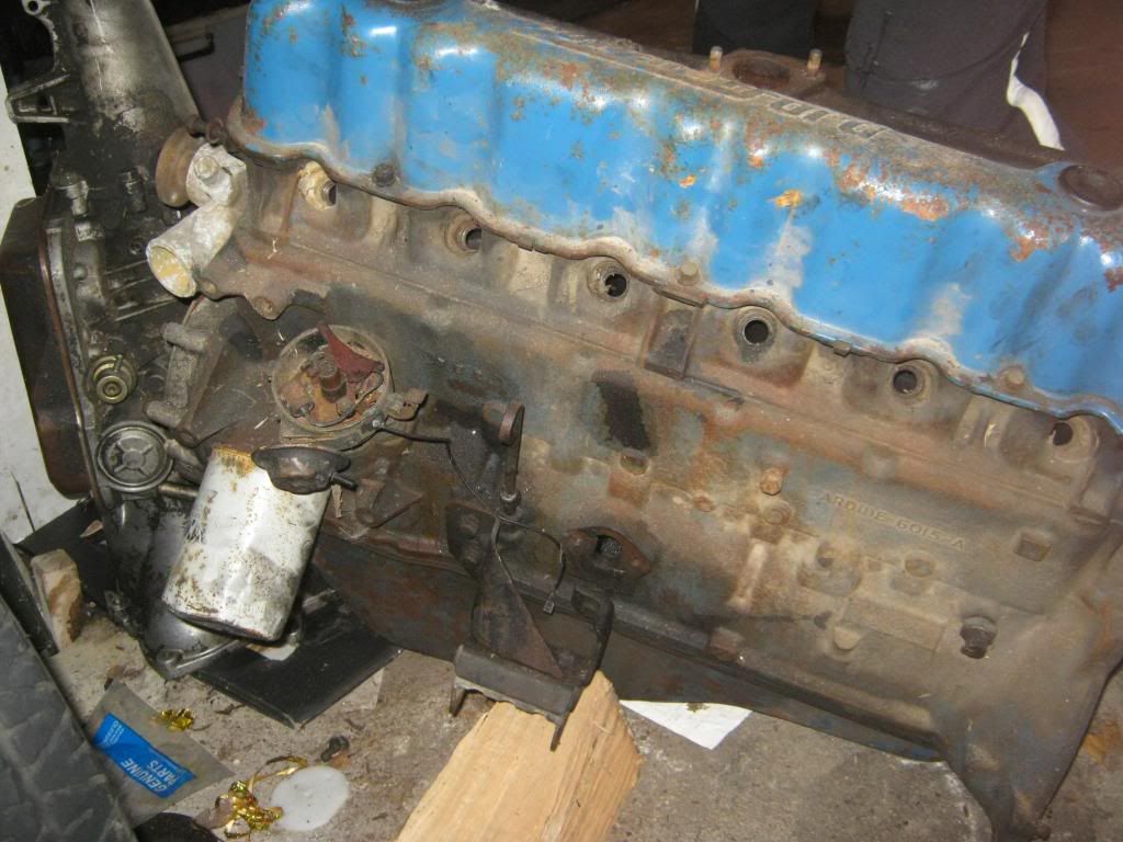

I was looking at the pictures of your engine and have one question.
Is the starter mounted above the oil pan or beside it?
If the starter's above the oil pan, it is a 200; if it is beside the oil pan, it's probably a 250.

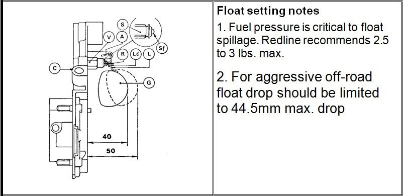

As for float settings, you can use whatever set up instructions that cam with the Weber 38 in its orginal Ford Capri 3000 or Scimitar, AC ME 3000 or TVR application, and that was
The 32/36 DGAV and 5200 Holley Weber had similar set ups, but it depends on if you have a plastic or brass float.
But other sites have other recommendations, like this http://www.ladaniva.co.uk/baxter/resour ... erSwap.htm
While it's apart it would also pay to check that the float level is correct. The float valve and float are in the top cover. Redline Weber recommend DGV float settings to be 38.5/46.5mm (plastic float), and for aggressive off-road float drop should be limited to 44.5mm maximum drop. Weber North America advise 35/51mm for plastic floats with F50 emulsion-tubes, or 36.5/46.5 if using an F6 emulsion-tube.
Note that the older style brass floats have different settings to the plastic floats at 40/50mm (Redline), 39/50mm (Haynes), 41/51mm (Weber North America). Plastic floats are better off-road (less bouncy), and more reliable.
Brass vs plastic float settings (Formula Ford)
Brass vs plastic float settings for 32/36 DGV on a Formula Ford race car (click on image for bigger view). Note these are for an engine that spends its life at top RPM and on a flat surface - see above text for suggested settings.

Starter is above pan rail.
Block Numbers:
Casting Date "6A24" 1966, January 24th
Assembly Date "6B14" 1966, February 14th (stamped on left front ear/tab)
This is the original block to this car.
I measured the stroke with a long screwdriver, TDC to BDC, and it measured 3.75"-ish, greater than the 3.1" stroke of a 200ci
Photo of stroke measurement:
http://www.supermotors.net/getfile/9890 ... g_0266.jpg
RodC

Well one thing is for certain it is the original engine block to this car and may be one of the few things that is original to this engine.
1: Head is a "D3DE" Big-Log
2: Came with an LOM and replaced it with a reman "C7DE" distributor (Faron may see it over the winter, lol)
3: Measured stroke with a long screwdriver and the marks were nearer to 4" (3.75) than 3"
Photo of stroke measurement;

Here's a photo of the FP mounting boss:
http://www.supermotors.net/getfile/9890 ... g_0267.jpg
OK you do for sure have a 200, but the problem is that the 250 crank stroke lenght won't fiscally fit in a 200 block as the cam is too close to clear the rods. About the max stroke length that fits in a 200 block is 3.46. Good luck

A 250 crank will not physically fit and rotate in a 200 block; the cam is located too close to the crank centerline, that and the 250 crank bearings are larger than the 200s. Ford moved the cam farther away from the crank centerline in the 250 to allow a larger throw; that is why the double roller chain from a 200 won't fit a 250. The 250 rods were lengthened (4.715 to 5.88)to keep a decent rod/stroke ratio (1.5) which dictated the deck height increase from 7.808 to 9.47. The Australians did the same thing on their 250 but the cam is positioned in a different place, and the deck to only 9.38"
See how many bolts hold the water pump on; three it's a 200, four it's a 250. Also the US250 never came with a high mount starter (above the oil pan).
I was thinking how you could come up with a 3-13/16" (3.8125") measurement in a 200 and believe I came up with the answer.
When you measure the stroke, a stiff thin wire like a coathanger should be used and it has to be held as vertical as possible. If you don't, everything is measured at an angle. With the sparkplug hole located where it is, and with its orientation, the screwdriver you used is probably touching the opposite side of the cylinder at BDC; when the piston comes up you are able to move the screwdriver closer to the spark plug hole. This could cause a larger measurement than the 3.126" for the 200.
At an angle, you should be able to insert a screwdriver (or a thin wire) 4.5"+ into the 200 cylinder.
Whatcha think?

I think you make a very good point about the measuring variables, center of piston vs outer edge. I thought I made a valiant effort to take that into account where the screwdriver would land on the piston at BDC and the .75"-ish seemed soooo close to 3.91" stroke. I had made my marks at the VC lip/flange and trying to keep the screwdriver perpendicular as the piston descended. This definitely a 200ci OE block. Was there also a difference in the number of core plugs between the 200 and 250? Mine has five if it matters and the as I said previously the starter is above the pan rail.
I believe what you said regarding the clearance issues in the cam/crankcase cavity.
Both the 200 & 250 have 5 freeze plugs so best way to ID them apart is water pumps the 200 has 3 bolts holding it on a 250 has 4. Than its the deck height differance and the back of the block ie the bell housing bolt patern 250 has the same as a 6 bolt bell SBF V8. On stroking a 200 to a 221 to 228 cu in. check the link below it goes into the details for parts needed.
