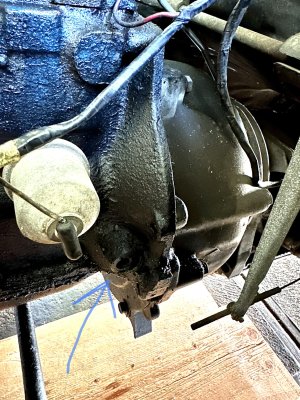

Noticed this opening on driver's side of where the transmission meets the engine. Is something supposed to go here? IMG_7491.jpg
Let's see if one of the experts can chime in. I just came in from the garage and took a shower. If you don't have an answer by tomorrow when I go back out, I'll crawl beneath mine and have a look. :beer:
That where the ball for a manual trans clutch Z-bar bolts in. Not an open port, it's a threaded mount point, doesn't go inside the block.
Oh got it thanks! I’ve got the C4 so I won’t worry about it, making sure I wasn’t missing a part haha
