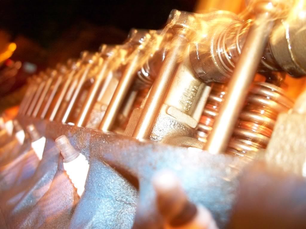

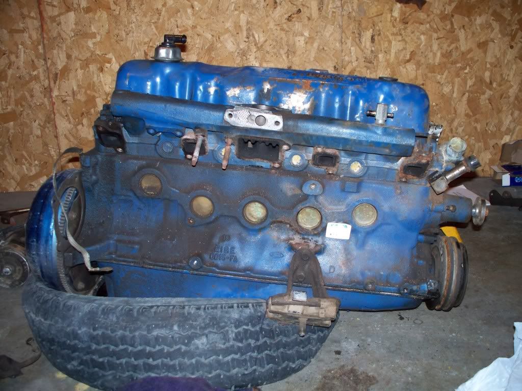

i got the engine today ! the guy was nice enough to drive it to me and drop it off for $50.00. All together $250.00. Not bad in my book.
I took off a lot of the junk, and took a look inside. Besides the water, it looks pretty good. Normal wear it looks like. After work i tore off all the silly emission stuff. Here are some thumb nails, click to enlarge.
Here is a pic of the carb.

Yep, 81 block,1345cc head.

So it's an 1981 200 big bell with a 3H crank huh ? Meaning i can hook just about any transmission i want, I.E V-8 transmissions yeah ?
i'm thinking i'm going to strip it down all the way and start rebuilding it. i still haven't decided on a transmission tho, i'm thinking about a T-56, thanks MPGmustang.

I really don't know enough to answer the big bell part. My thinking was the low mount starter using the reg SBF bell housing was what they were referring to.

Looks like a high mount starter to me.

The block casting number gets you close but to know the true year of your engine you need to look for the actual casting date this will give you exact day that it was cast! The casting date for example will look like this "6M08". :hmmm:

That's my point. Am I correct that the big bell is the SBF low mount starter bell?

8) yes the big bell is a low mount starter, and the one in the picture is a high mount starter.

Doesn't the E0 head have 1420 cc log intake, or is it only the E1 head?
Even if your head only has a 1345cc log intake, that's still a good one to have.
Unfortunately, your engine cannot use a SBF bellhousing or AOD transmission, only a small bell C4 or 9-inch six bellhousing/clutch.
Your purchase was still a good one.

so it has a block code of E1BE-FA which is from 1975-1980, then it has an intake code of E0BE-BB which is from 1981-1983.
High mount starter with the 6 bolt bell.

That thing that is in front and on top of the manifold is part of the emission system. Take it off and plug it, not needed.
The thing sticking out the block that's up front on top by the manifold I'm guessing is a coolant bypass and utilized by the emission system. It could be the hose that goes to the heater. Did your carb have a spacer under it with coolant lines attached? When dealing with these later engines you have hoses and vacuum lines going everywhere.
If you look on the side of the log intake beside the carb hole, you probably had an EGR valve mounted there. You can cap it off, or fill it in if you do a direct 2V mount.

if i got the head cleaned up a bit so it's totally a bolt on, how much could i sell it for ?
there's no way to do a triple carb with the manifold, is there ? Sorry for all the dumb questions, thanks everyone.

there should be a kit for your head to use three carbs.i fairly sure theres two kits.one for each type of head.

As everyone is saying, the Head is from the early 80's but the block itself is from the late 70's. I have a true Big bell with the low mount starter from 81. It has a block casting E1BB. The grommet in the front of the valve cover is for the pcv valve. These engines did not come with coolant spacers under the carbs this late in production. That stopped in the the mid 70's. The "thingy" in the manifold in the front is the vacuum ports for running your carb and fuel vap canister off of. You can definitely get rid of all that smog crap and go to simple straight vac hoses if you wish. I have a holley 2300 350cfm carb on adapter running my power plant and it has made a world of difference on my motor. DUI dizzy to give it the extra kick in the pants and a set of mikes dual outlet cermic coated headers to make her breathe. I had to modify my headers a little but with a high mount on your motor, you wont have any issues.
