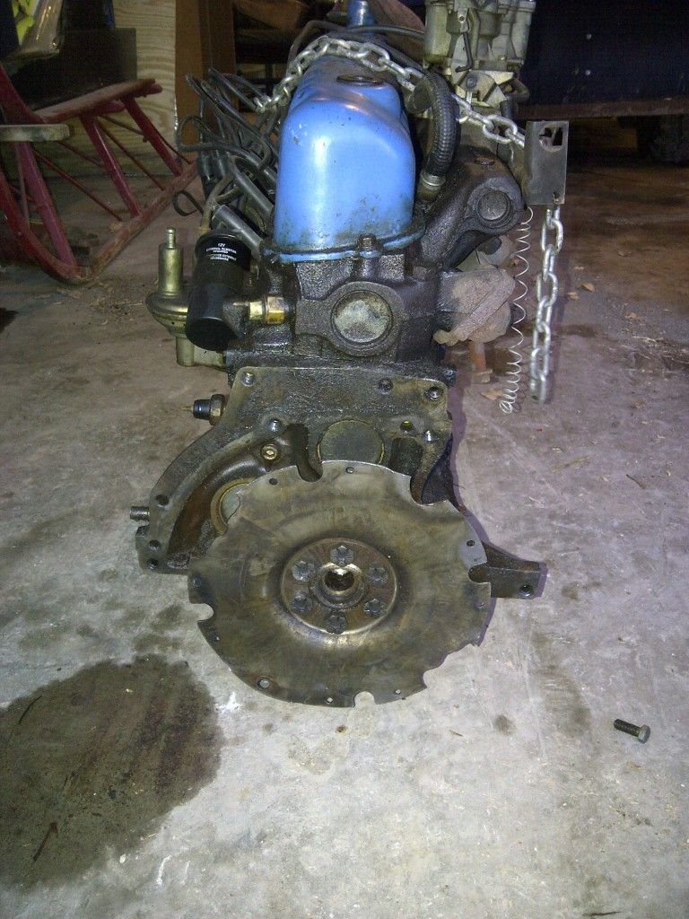

"200 out of a FOX body. if you find a standard bell 200 you can use the drivetrain you have now but if you can find a large bell 200 you can just set it up for a SBF bell."
When you say find a large bell 200 isn't that what I have with my C8DE block? The distance between the top two bell bolts is 5.5".

Here is a picture of a 170 that I recently bought from CraigsList. It shows the dual bellhousing pattern, and part of a one horse open sleigh :roll:
adapt a big bell to v8 (from the tech section)
http://www.fordsix.com/V8Bell.php
