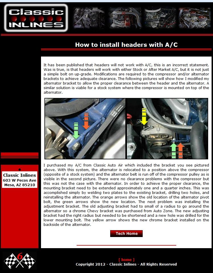

Since all Ford 200'S and 250's after 1966 came out with a factory option Tecumseh/York/Motorcraft A/C unit in no way similar to the one listed, the advice needs to be related only to Sanden A/C units. A number of 170/200'S had generators too.
2V head, Classic Inlines or Vintage inlines head, or or header exhaust definately doesn't work with a factory option Tecumseh/York/Motorcraft A/C unit.

The article above is not relevent to standard factory 200's and 250's.
If aftermarket non Standard Sanden, then its great/excellent. :thumbup:
If you want to keep a 250 Fridgidaire/Harrison A/C unit, your screwed unless you go Sanden.

Here's what it looks like in my build. Made some stand-offs to move the alternator away from the header. Came out pretty good! The longer belt needs to be about 1/2" shorter, but other than that, it's time to clean and paint.
It looks like the alternator is still sitting on the header. It's just the angle. There's 4" between them.
The differences between low mount Sandens and the stock York positions are huge, so consider very carefully your options.
