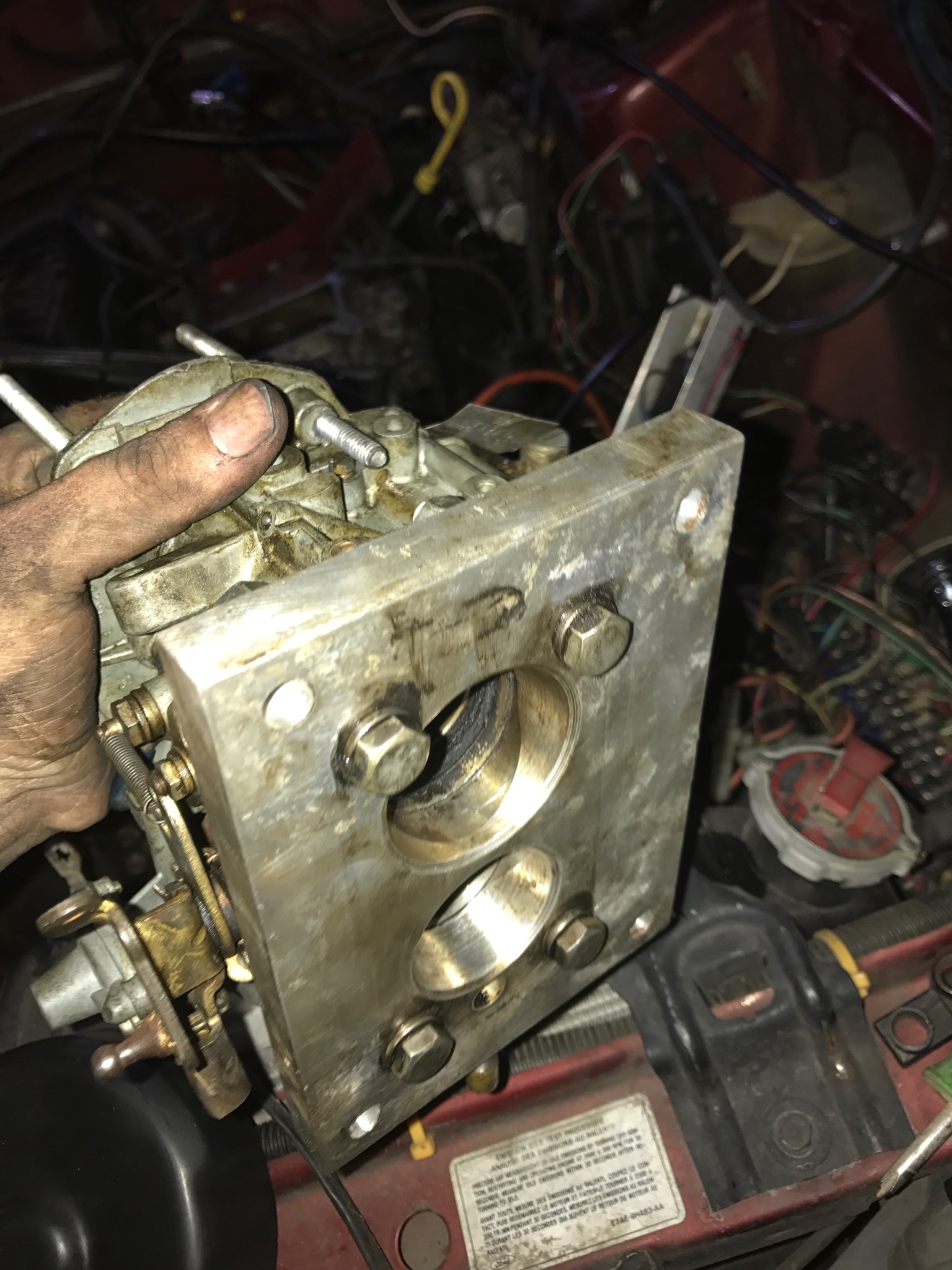

66 200 - C4 - 1100 carb. Upgrading to Weber 32/36 and Duraspark II. After removing the 1100 and base plate with vacuum barb for PCV and replacing with 32/36 and base plate without a vacuum barb for PCV, where do I hookup the PCV hose? Can I replace the PVC with a breather - the ones that look like mini air cleaners?
So far, I've been told that I can hook it up to the same port that the C4 uses for the shift modulator. I've also been told that that is not a good idea. Would like to hear from those who have actually done this swap where the trans is an automatic and not a stick.

Drilling and tapping the spacer is not going to be possible. The Redline spacer is only a 1/4 inch thick and the bottom side is concaved, so not even that thick all the way across. The adapter is from Vintage Inlines and consists of two pieces - the bolt on adapter and an insert - and I'm not about to drill through both of those.

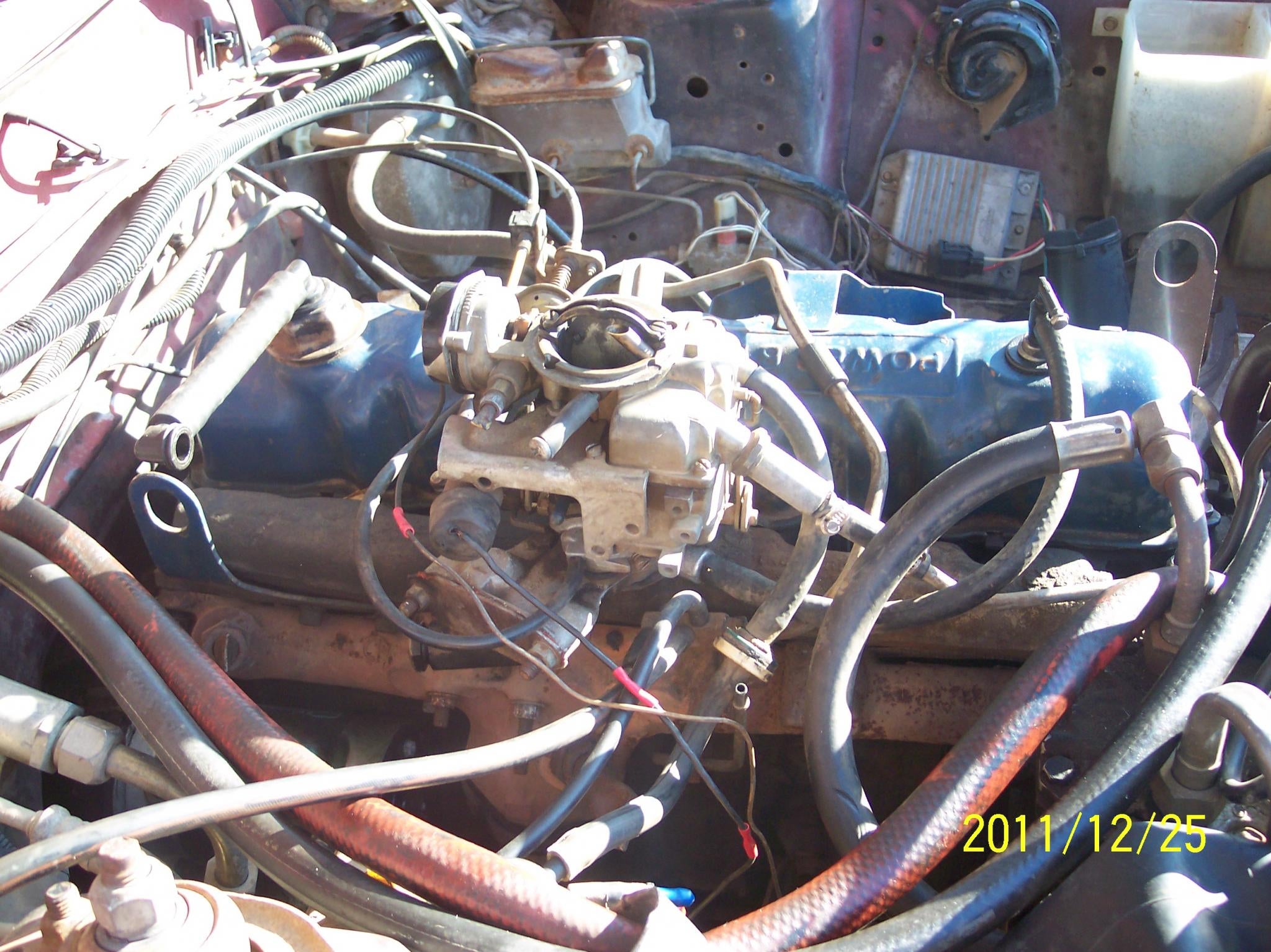

My suggestion is to yse the Fox body 3.3 system, seen here in three version, each with the very common (non standard) Carter YFA 1-bbl carb off an F150 truck.
On later carbs (post 1970, and certainly after 1973), they had a delicately balanced Purge CV ( Vapor Canister Purge Valve) which stole the BV, bowl vent vapors, vented the stuff to an activated carbon canister. There were Delay Check Valves to sort out reducing surges. Any problem with the grommet or PCV, and the carb would surge like a B -tard.
Element 1: Lower Line to under the carb. EV89 PCV valve on the Fox body rocker cover puts the oil filler at the back.
The PCV valve hookes to a 3/8" grommet, and the line goes under the carb on an adaptor like this
The lower manifold BSP bolt (also used for the power brake booster) can be used as a last resort if its head is 1960-1979. The later 80-83 heads are like the ones above. I'd personally use the stock adaptor.

On your car, the later 4.9/300 F150 air cleaner fits under the hood with a YFA on top of a 200,
and the whole 300 Ford truck PCV system
The air cleaner on a 300 F150 truck
