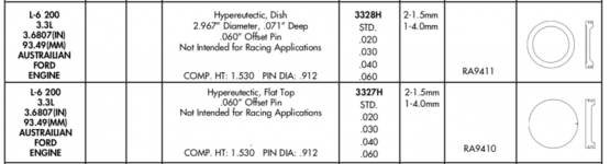

wsa111":1j3fyjgr said:
If you want more low end you might want 4 degrees of advance??? The wrist pin offset also affects low end, mod-range & top end.
What are your specs on your piston choice?? How much offset??
Bill, piston specs in the pic below:
xctasy":1vq8yni5 said:
Your bore texture needs to be set up smooth . Have your machinist supply Rpk, Rk and Rvk readings from a laser profilometer.If he can't, get another mschinist.With hypers, the bore texture needs to be set up like an EFi OBD-ii engine with 10, 15 and 23 respectively. Ring tension should be 3.2 lb-ft+/-0.2 on the compression rings, and 10 lb-ft +/-1.0 on the oil controls. Crome or ductile iron is irrelevent as long as you follow the run in requirements.This is totally contrary to how Fords bores in the 60s to early 80s were set up rough, with Rpks of 15-20, Rks of 45 or so and Rvks of 55 or so, just like small block Gen 1s. Average Ra has nothing to do with bore prep for a hypereutectic piston. Old specs for Fords 3.3 US pistons were for a different kind of bore texture than we need in 2019.
Thanks X. I’ll pass this info along to my machinist.
