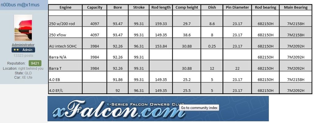

noobus":25k53qnm said:
There is a few indiscrepancies in the line up as ive found a few errors on ACLs site so i just wanna throw this by everyone here first before i start ordering parts.
Line 3, 30.88/25.4 +1.2157" (difference to 30.90 or 1.2165 is a metric rounding error typical of the SI system)
Dish is 0.25 cc's.
An other measurementfor the con rod is 6.057 instead of 6.058".
Whats 1 thou between friends...an engine rebuild!
ACL is just an appalling website. NCAA= No class at all, but errors everywhere. I guess if you put no info in it, you won't make any mistakes....
I guess its all bankrupt and sold off to the lowest bidder now, like the Aussie aftermarket, heading down the gurgler...
http://www.aclperformance.com.au/Ford4. ... istons.htm
