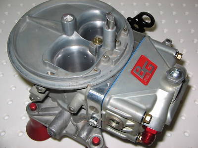

Best non Weber choices:
I'm quite sure a routed out 2300 series carb with 650 cfm like the 1.4375" 37 mm #6245 sieries 2-BBL,
or the brilliant, unlimited # 4412 2300 series based aftermarket 890 cfm C&S 1.56" (40 mm ) 2-bbl carbs would make the best power.
There is even the Split Billet Dominator unlimited 2 barrel 2” with 1.69" (over 43 mm) venturi carbs for unrestricted V-8 2 barrel classes that outflows 890 cfm carb above for even more excellent power.
