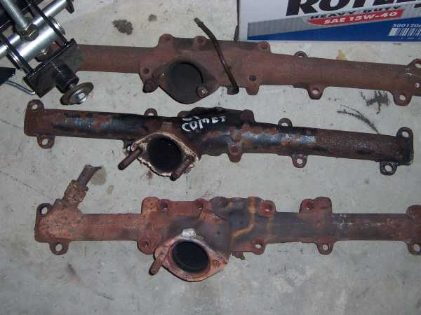

All Small Six Is this normal???
" I’m baffled. Every one of those three manifolds list different year/car applications."
all manifolds from 144 thru 250 will 'bolt up' - the differences reflect improvements (slight) and EGR' emmission req's thru the years. Important is different bolt LENGTHS to match castings era when ordering bolt sets.

Thanks for that info. 👍
I saw that about the longer bolts needed for some manifolds. Then some were listed as for “manual choke”. I don’t think that would be the right one for my 63????
