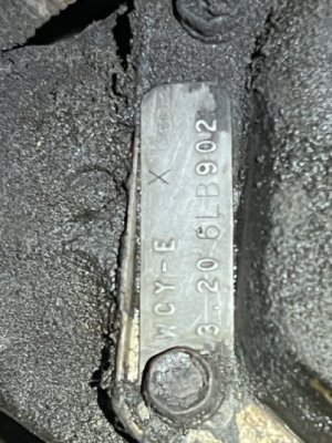

As far as changing the rear gearing goes, if you can find a rear diff out of a manual trans car, they have 3.20 gearing vs the 2.79 or whatever is in the auto cars. Freeway cruising in top gear is still very reasonable, but you will definitely notice faster acceleration in 1st and 2nd gears. It seems like the 7.25" rear diffs from the 6 cylinder cars are a dime a dozen, so this could be a very cheap way to add some zip off the line. If the metal tag is still attached to the rear cover, it will have 3.20 printed on it, identifying it as the one you want. Make sure to use one from a '65 to '66 Mustang, as the '67 and up are wider. This, plus a "shift kit" in your C4, and it will feel like a different car. I put a shift kit in my high school Mustang myself, so it's not a difficult job at all.
Here's a pic of the rear end tag. In my defense, this is when I first got the car - it's much cleaner back there now!
