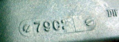

Your Block is at least a 1966 and may be a 1967 with that Block number of C6DE-6015-B this is because of the B at the end of the Design Number. There is also a Casting Date Code on the Block and many other cast parts, this looks like a small Metal Plate with a Straight Blade Screw Head on each end, it will have 2 to 3 Numbers and a Letter (see below attachment for an example of what they look like) with that Code I can tell you the exact Day that Ford Cast that Part at the Engine Foundry.
