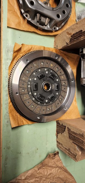

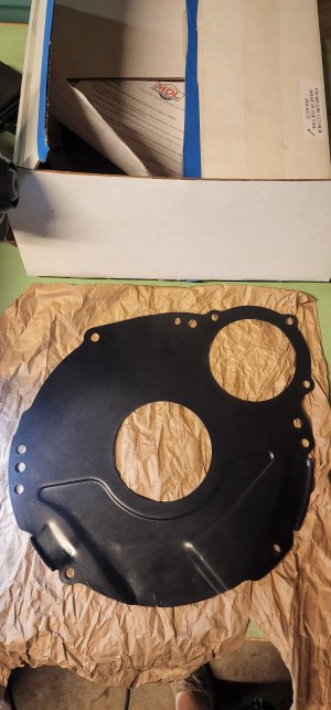

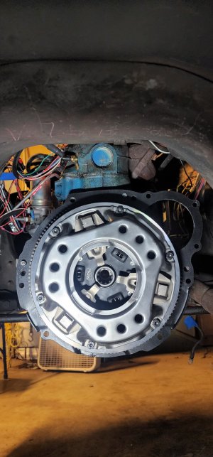

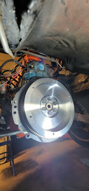

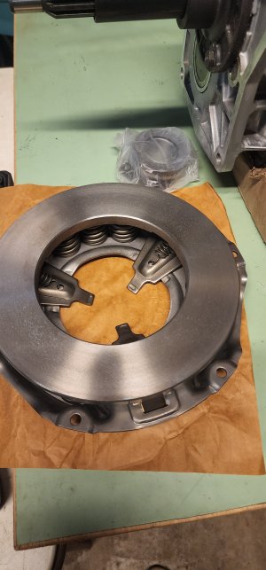

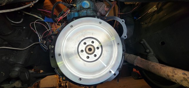

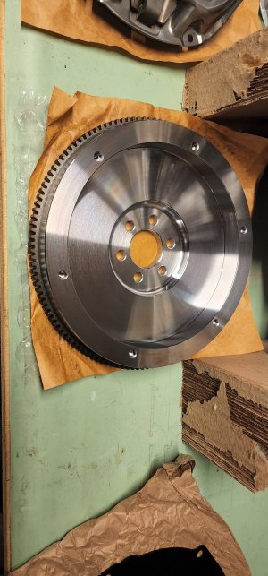

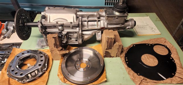

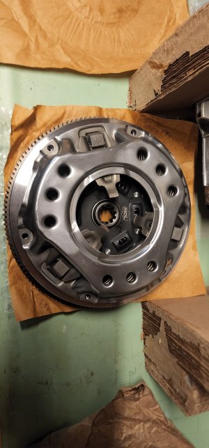

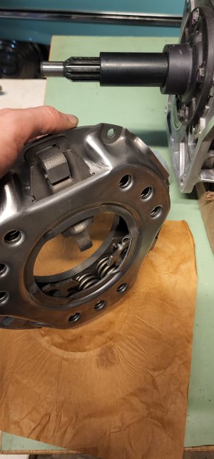

The eBay block plate and the MDL clutch package arrived yesterday in the morning. Both seem like matches! Another very late night in the garage and we installed as far as we could take things. Checked progress on the hydraulic mount, it's not going to be a piece of art but should get the job done! Unfortunately they have my bellhousing and adapter plate for checking dims so we can't just finish the trans install. Told the fabricator it would mean a ton to me and if I can pick up everything today I'd bring him a 6 pack!
Had a minor brake line leak from moving the brake master cylinder for access to the clutch master cylinder. Will bleed them today. I temp installed the trans mount to make sure parking brake would clear. Everything seems good but my parking brake hasn't worked in a while so I need chase that issue.
Big question now is this starter. If I get everything else and the install is smooth, I'm definitely going to be very tempted to bolt on my old automatic starter based on that link above. Trying to find more info. Any input on the matter would be appreciated.
Lots of photos for the next person installing t5 on the small pattern

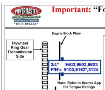

Definitely need to check and see which setup you have before deciding on a starter. That Powermaster photo above is a small piece of the whole page, which I included in the first post of this thread. My particular car has the ⅜" offset and 4.130" registry hole, two bolt starter.

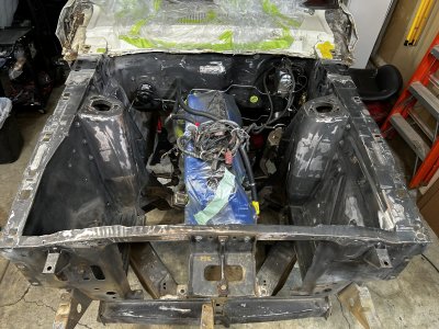

I have test fit and checked all dimensions, and it appears that my adapter flange is going to work perfectly. I haven’t been able to fire it up yet because my engine bay looks like this at the moment:

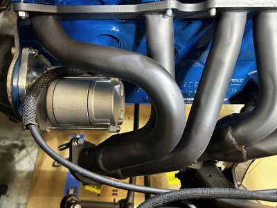

Major progress on this starter flange project - I rechecked all the dimensions many times and it looks like this is going to work. Won’t know until I turn the key for real, but that day is getting much closer. I got the starter installed and wired up, and test fit the header today to make sure it’s clocked correctly. There is actually a lot more room between the starter and the exhaust header than it appears in these photos.
Update: big setback to my starter project. One thing I failed to notice is that the diameter and tooth shape of the starter gear is very different between the 6 and V8. Got everything ready to fire today and the first attempt actually caught and turned the engine, the second try was a bunch of noises nobody wants to hear. Out came the starter and I could see where it was interfering with the ring gear. Not good. This is a real bummer after all the time, effort, and $ I’ve spent on this so far. I’m going to do some more measuring and see if there’s a way to modify the flange to salvage this project or not. We will see.
The good news is that removing this little starter with the header in place takes 5 minutes! If there’s a way to make it work, it’s a game changer.

@drag-200stang Glad to hear that you're not dead! I think that the FE starter is the same, as the 3-hole starters seem to fit both FEs and 200s with an automatic. I was trying to adapt a 289/302 2-hole starter to fit a 200 manual. The registry hole and pinion depth were perfect, but the diameter of the starter gear is definitely different. Perhaps I need to resume the project, starting with an FE starter instead of a Windsor.

My original starter has 9 teeth, and the outside diameter of the gear is 25.2mm. The 289 starter gear has 11 teeth, and its outside diameter is 28.8mm. The teeth themselves are a bit fatter, and the space between them narrower, than the 200 starter. The teeth/space size difference makes me think that simply offsetting the starter body in the mounting flange might not work. I’m going to look at the gear on an FE starter, and if it’s a 9 tooth that matches the 200 gear, then I’ll see if I can use this mounting flange on it, or if more design and prototyping is needed.
