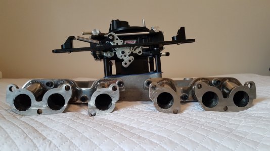

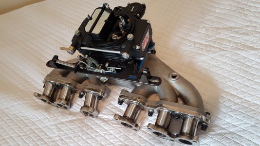

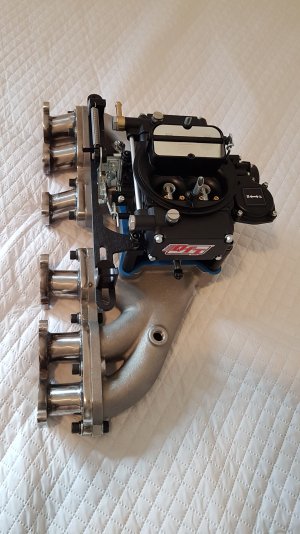

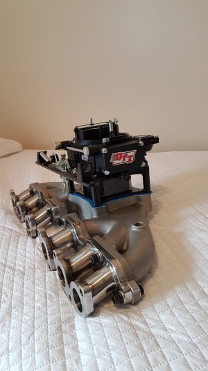

I did develop an adaptor with a locla mechanical shop in Brazil to adapt the aussiespeed intake. See some pictures attached from the time I was still using 4bbl carb and before I adapt the injectors.

Some pics of the aussiespeed intake adaptor for Argentinean 221 Economax Cylinder Head, when I was still using 4bbl carb, and a video after adapt the injectors.

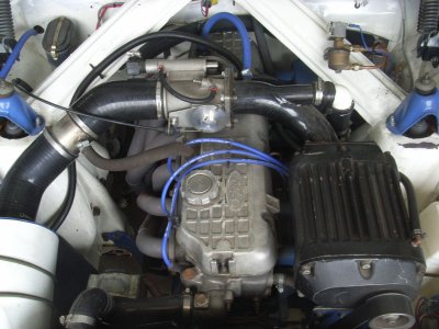

Very nice work. How much trouble did you have getting the manifold? The adapter you made is similar to what Ford used on the Crossflow EFI engines here, they have the injectors mounted in it just like you have done. What is the local supply of engine parts for the Argentine engines, eg pistons bearings etc? Just for your amusement here is my crossflow six, its 3.3litres.RIMG0044.JPG
So, it looks like the Argentina cylinder head is similar to the Oz 2V head being a non-log style head with a separate intake manifold....? Wonder what its performance potential is...?
At least as good, possibly better with true separated exhaust ports. Not as good as Australian crossflow head.
