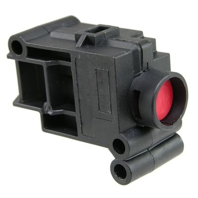

4
this is the fuel pump inertia switch.
these could be in MANY places depending on the year and exact model.. in the trunk on the left or right hinge brace.. in the trunk down in the wheel well.. usually with a hole in the plastic panel to push the button through...
could be in the left kick panel in the drivers foot well... look for a hole where the parking brake release is.. or the hood release.. in the panel to the left of your left leg when sitting in the driver seat.. and the hole is usually flat.. like one in a pool table..
Read more: http://forums.mustangandfords.com/50-mu ... z41MWjLzRu
